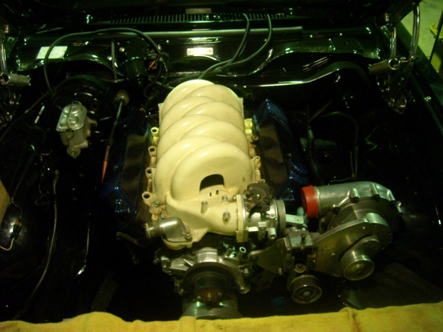

Supercharged Torana:
Engine: VL 304 block with flat top pistons, Match Ported inlet, Waggot supercharged friendly cam (cant remember specs but its big ish with not a lot of overlap), STA centrifugal supercharger runs 10 psi @ 5000rpm (nor linear boost, more rpm = more boost) , Surge tank with Twin VL pumps feeding fuel rail. 60LB siemens Injectors, commodore 808 computer with $12P, 2 bar map sensor and v8 knock sensor gear.
Driveline is Ford T5, and a chopped Borg Warner commodore diff thanks to Holden202 with 3.45:1 gears.
Tune:
DSCN2327 (640x480).jpg (216.24 KiB) Viewed 6753 times
Drag run: this came in at 8.88 1/8th mile
http://www.youtube.com/watch?v=5qKb5n8n_LA

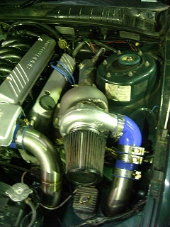

Turbo VR:
Engine: Bog stock VR manual 304 unopened with T04Z turbo running about 11 psi, front mount cooler, 60lb siemens injectors and 350 LPH fuel pump off a surge tank. ECU runs $12P with 2 bar map sensor.
Driveline is T5 and 4.11:1 diff gears.
Tune:
OSE_$12P_V110_304 Turbo 2 bar 12-03-2011.bin
(32 KiB) Downloaded 410 times
1/8th Mile Run was 9.06 seconds:
http://www.youtube.com/watch?v=bi9k-wwvpkY
this car feels fast but I think the ignition breaks down a bit at high boost. has been interesting to tune.

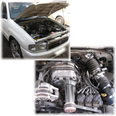

L67 Mazda Ute:
engine: VX L67 with Comp Cams stage 2 cam, Roller Rockers, W2A cooler, 70MM TB, 74MM MAF, M90 with Teflon coated rotors and 14PSI (3") pulley, T5 gearbox.
This isnt the best drag run, the track was wet at this point and he spun the whole track, it was 10.25
http://www.youtube.com/watch?v=pAAwsodlez8
Tune:
DDRJ-cam-knocksensordisabled-12-03-2011.W81.bin
(64 KiB) Downloaded 377 times
