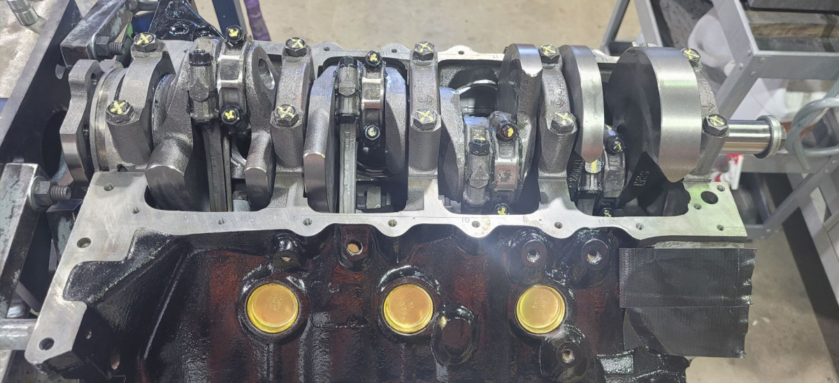

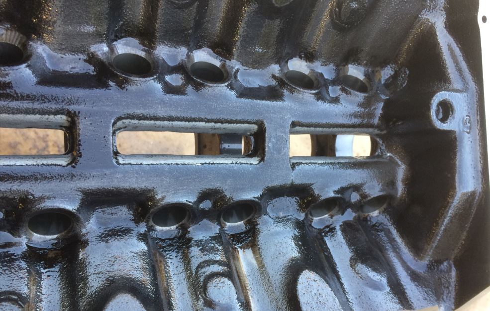

I had deburred the oil pump gallery inlet and did minor clean-up of the valley before I sent it off for machining.
The metal is pretty soft and cleans up really easily. I didn’t go too crazy, just took off the casting dags. You see some go to the trouble of polishing the valley, but I am not sure this is beneficial as it reduces the surface area for heat transfer.
I’m not against the rear seal conversions but I am just running the factory rope rear seal.
I think if you keep your oil changes up, and keep the PCV system in place with a vacuum in the sump, there’s no reason why a rope seal shouldn’t last (if you keep the revs down as well). Let them breath to atmosphere (or through catch can then to atmosphere) there has to be a positive sump pressure which is asking for trouble. If the PCV is working there should be 0.5” H20 vacuum in the sump (at idle) which solves a lot of issues. Having said that, this one was leaking - but the rear main in my one tonner is still ok with well over 300000kms on the motor.
I didn’t plan on doing any oiling mods other than just a spot of weld over the cam bolt oiler, and redrilling it so it now faces the gears. The other chain oiler is still in place.

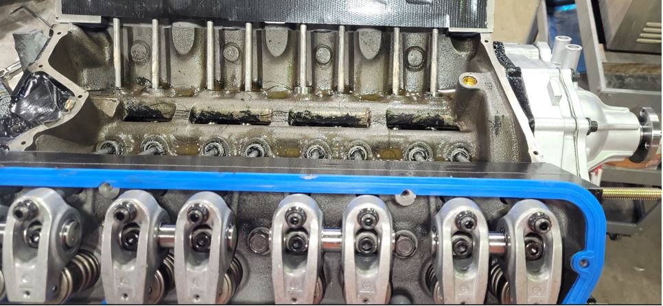

Heads are on and torqued up. I am always hawky of the middle bolts as they never feel quite right to me. I just settle for the lower end of the torque spec and leave it at that.
Rockers are just the Street Terra adjustable.
Shame the rocker cover gaskets aren’t a plain black colour so they don’t stand out as much as what they do.
But engine is more or less assembled now.
