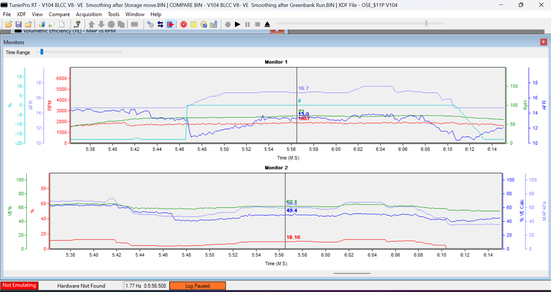

calcve needs wideband, so its nonsense data here. narrowband cant see far enough outside stoich to be used for calcve. wideband is just pegged because there is no connection on that pin. You can select the whole ve table and add or subtract to offset the whole lot or tweak the injector flow rate, but dont forget you did it and undo it later or you can make unintended new problems.

I've installed the wideband 02 and had a few runs to sort out the over-fuelling/VE table. It's getting better but still needs a lot of adjusting and smoothing. During some previous logs I've been getting excited and doing a bit of a power run (sounds mint), but shortly after I am cleaning spark plugs on the side of the road, to get home.
I've since stopped that and just working on cruising and getting it to run smooth during regular driving.
I had a quick question about the INT/ integrator. I read on other threads that it accounts for rich fuelling in attempt to lean it out. I brought it up on my Histogram and it is running at like -17, then zero's out and Target AFR goes all the way to 17.5 but my wideband says I'm down at 12, which might be contributing to the over-fuelling. I'm not sure why that happens if someone could shed some light on it? I have a DTC for O2 rich fuelling as well. I have an assumption that because I've been fouling plugs with a rich fuel mixture, my O2 sensors might need a clean too? Log and bin attached
