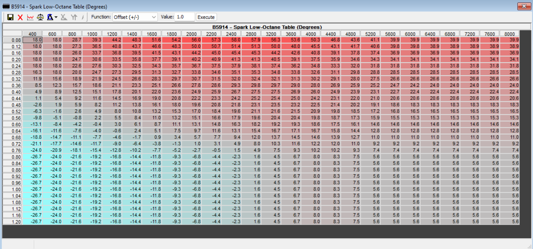

Ive been looking at 12587603 disassembly some more and i cant seem to figure out how the axis's are referenced. i can see where the variables for the axis's are pulled from RAM but how the axis's are actually read are still a mystery to me. anyone have any insight on this?
im studying how the main high octane ignition table is read.
OS1:00039FAC 3038 AEDA                           move.w  (RAM_RPM_2).w,d0 ; move RPM from RAM to register D0
OS1:00039FB0 3238 AEDC                           move.w  (RAM_MAF).w,d1  ; move MAF from RAM to register D1
OS1:00039FB4 7419                                moveq   #$19,d2         ; Move Quick
OS1:00039FB6 207C 0001 0E3A                      movea.l #SPARK_ADVANCE_KA_MAIN_OT_LOW_OCTANE,a0 ; This calibration determines base spark 'bad fuel' contribution to spark advance.
OS1:00039FB6                                                             ; Degrees
OS1:00039FBC 4EB9 0002 6994                      jsr     INTERPOLATE_TABLE ; Jump to Subroutine
OS1:00039FC2 3240                                movea.w d0,a1           ; Move Address
Posts: 8996
Re: Trying to figure out how P59 axis's are referenced and where
INTERPOLATE_TABLE is the 3D lookup routine. A0 is the address of the table, D0 (word) value searched on the X axis, D1 (word) is the value searched on the Y axis. d2 is the size of the of X axis, and the result comes back in D0 as word. So in the above, 19 hex is 25 cells of the table in the X direction which is the only dimension it needs to lookup the value.
If you look at the table, 25 cells in the X direction (400->8000).
The values are scaled before going in to the routine to take into account the axis so the lookup function does not need to know the axis beyond the X size.
So RAM_RPM2 is really RAM_RPM_SCALED and RAM_MAF is RAM_AIR_GPC_SCALED (or something like that). Where GPC=Grams Per Cylinder.
You'll find the scaling code between the ADC read and what writes it to that location in RAM. And all the rest of high and low octane scaling code, just to really keep you on your toes.

So... If it was 1a instead of 19 it would automatically jump to the first cell of the next row? In other words it reads the table as a single row essentially?
Or am I misunderstanding and it jumps 25 cells depending on the y axis lookup.

Do you mind elaboration, maybe with another example further down the table?

thank you for explaining that! makes a lot more sense now! so looking at this if you wanted to changed the Y axis to manifold pressure instead of grams per cylinder all i would have to do is change what is looked up in RAM instead?
