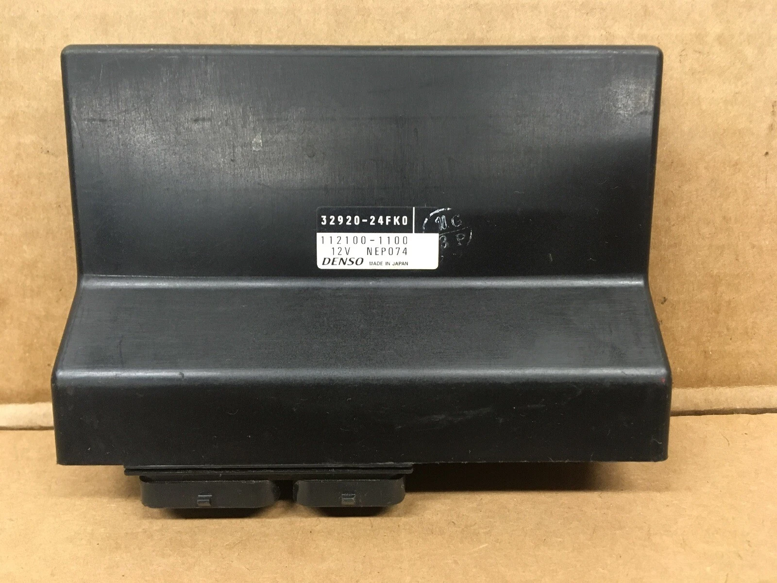

antus wrote: Mon Jul 15, 2024 3:48 pm Who is the manufacturer of the ECU? Is it a well known one?
Both are Denso, they are not exactly the same but they are super similar, so I think they should work pretty much the same
Gen 3 22-24 part number 32910-10L00
Gen 2 08-21 part number 32920-15h10

antus wrote: Mon Jul 15, 2024 9:16 pm Interesting. Same case but each version has quite different connectors.
The gen 2 Hayabusa and gsxr 1000 2008 also have different connectors, but you could flash the gen 2 bin file on the gsxr 1000 and use the turbo maps too, everything still works, both bikes have 8 injectors and all.
The Hayabusa 2022-2024 and gsxs 1000 22-24 also use the exact same ecu, just different bin files that are flashed with SDS-II at the dealer, when they get it ready for showroom.
