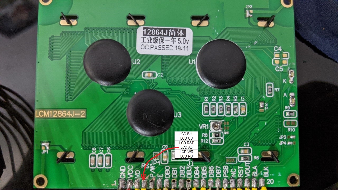

Posts: 10435
Re: ALDL Logger V2
I've had a bit of experience with logger screens, my person one the backlight failed, i was able to replace it and all good again, i've also had issues with no recording of logs, but in my case it was a new SD card and off it went, been looking at the same issue for Gareths logger, new SD card didnt fix it.
one thing to check when the backlight fails the screen still works, you can usually see it if you shine light on it at the right angle, theres a few pins up the end of the screen BLA and BLK, i believe these stand for back light anode and back light cathode .....
BLK (first pin from the left when looking at the logger from the top) is controlled by the logger through a transistor to turn the ground on and off (dependant on the backlight setting in the logger) you can ground this to go 100% backlight and confirm its not the issue.
BLA (second pin from the left when looking at the logger from the top) this is 5v to the backlight with a resistor, i cant recall but i had a feeling it was 3.3v or similar, anyways if it has no voltage on it that may be your cause too.
this is not the actual logger screen, its just one i found on google, but shows the power / ground / bla / blk pins.
aside from that, i can only suggest your screen is the issue, and if that is the case, i found it very hard to find the right screen recently, new ones look right but they are SPI, the two CS lines that we need are not on them and they dont work on the logger (PSB & NC in above pic)!
as for removing the screen, i have found a few ways to do it, back when VL400 was still around he told me to cut the pins with a grinder, or side cutters, then once the screen is off, remove whats left with the soldering iron, then install a new header strip with the new screen. You can also blob a heap of solder on the top and run the iron along the pins and slowly pry it up but this is a more risky method and painfully slow :)
