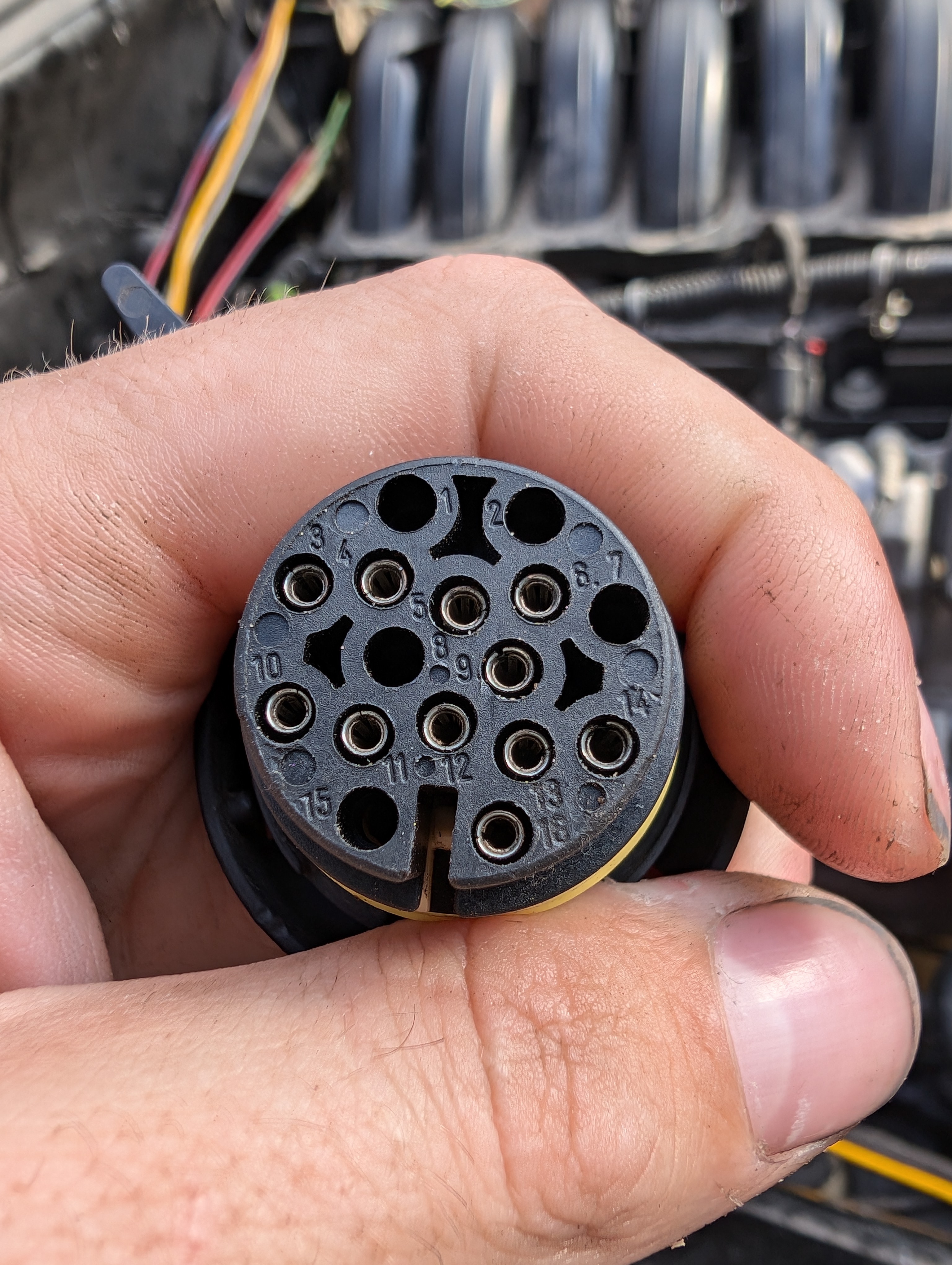

antus wrote: Mon Jul 15, 2024 9:18 pm @tonn0297 do you mean chip level pinout? Not TCM connector pinout? I am thinking the TCM connector should be documented and you can see any power pins changed that might cause that DTC and be something fixable with wiring.
yea i mean chip level, as the TCM connector sadly dont have any of the solenoids pined out to messure on. Ill recheck the TCM plug, and flash the 4908 back into it to see what happens.. i wuld be sad if indeed a software issue, as i do not assume i can swap CAN msg over from a newer os..

And my trans is a difrent pinout, I do not have any pins in 1 and 2
Schematic ive found
Tranny WD.doc
(97 KiB) Downloaded 399 times
