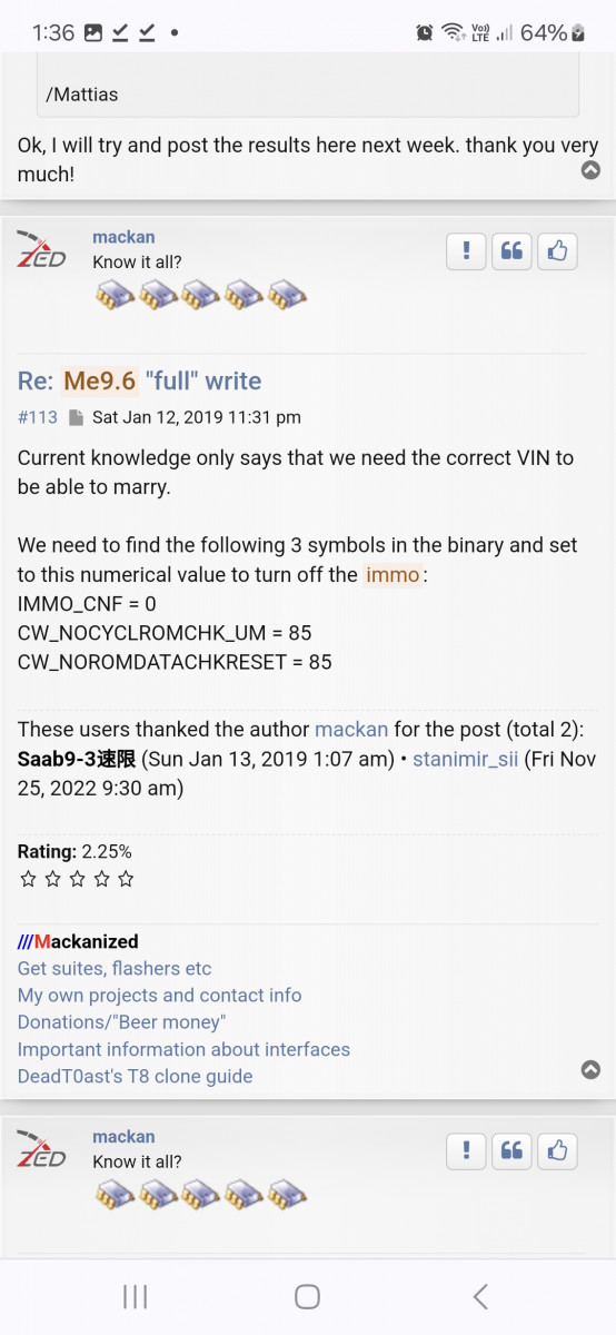

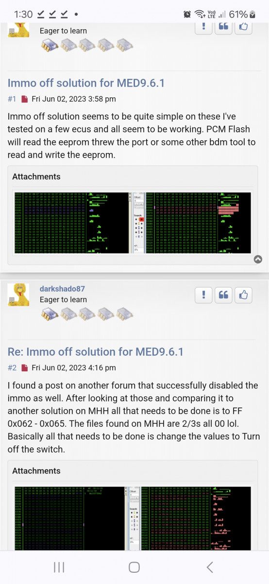

VZ Immo Off
Posts: 5623
VZ Immo Off
I'm currently trying to figure out vats off
Posts: 5623

Has this been tested?!? if so this is great news!!
Posts: 4810
Re: Why I hate VZ V6 ECUs...
nice work Delco, hopefully its that simple!

Posts: 3546
cars: VE SS Ute
Location: WA
Post by Tazzi »
Oh thats interesting!
I wonder if the E69 is similar also to the E77, both being bosch units.

Posts: 5623
Need to read and write the eeprom somehow
Posts: 2959
Post by VX L67 Getrag »
That can be done with fermec tool!
Posts: 8996
Re: VZ Immo Off
I split this out, its a good topic, but not related to Tazzi's tool. I don't think the holden solution will be the same as the saab one. I believe the solutions are implemented differently for different OEMs Bosch sell to. But please test and let us know results. Until then, we just don't know. But certainly try it.
