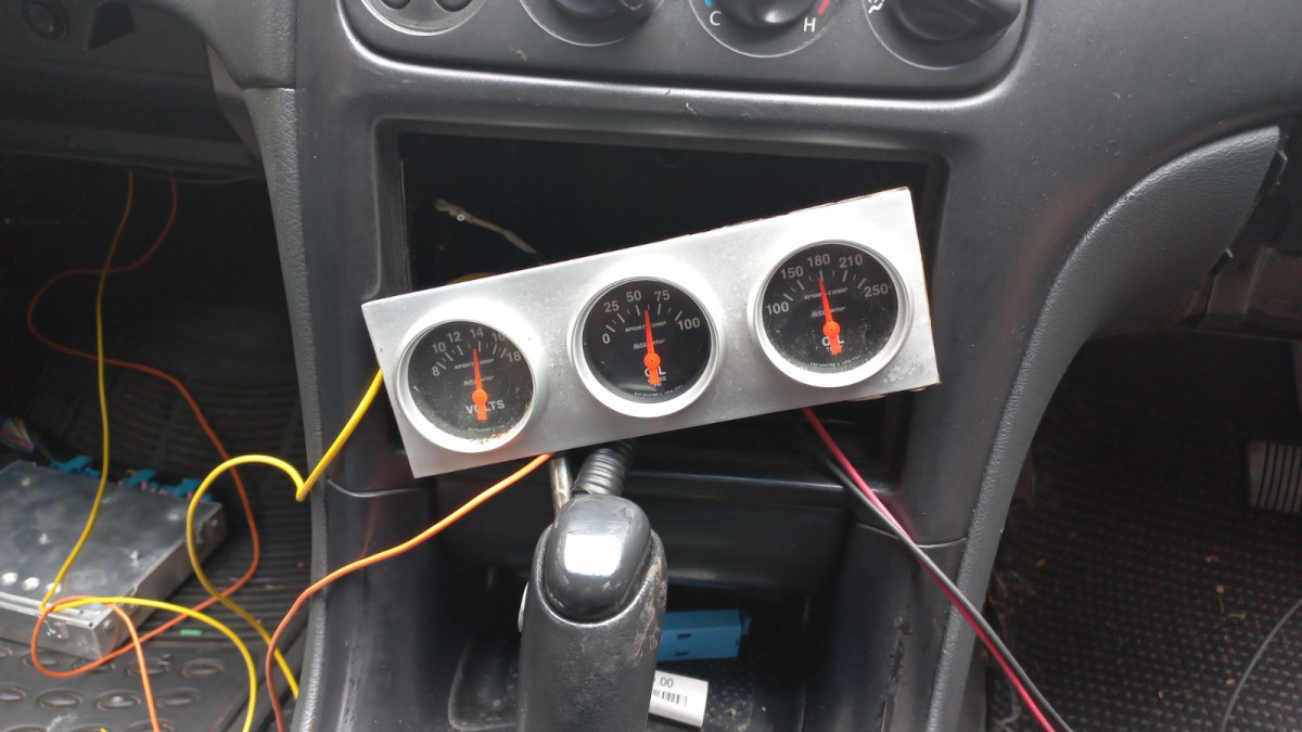

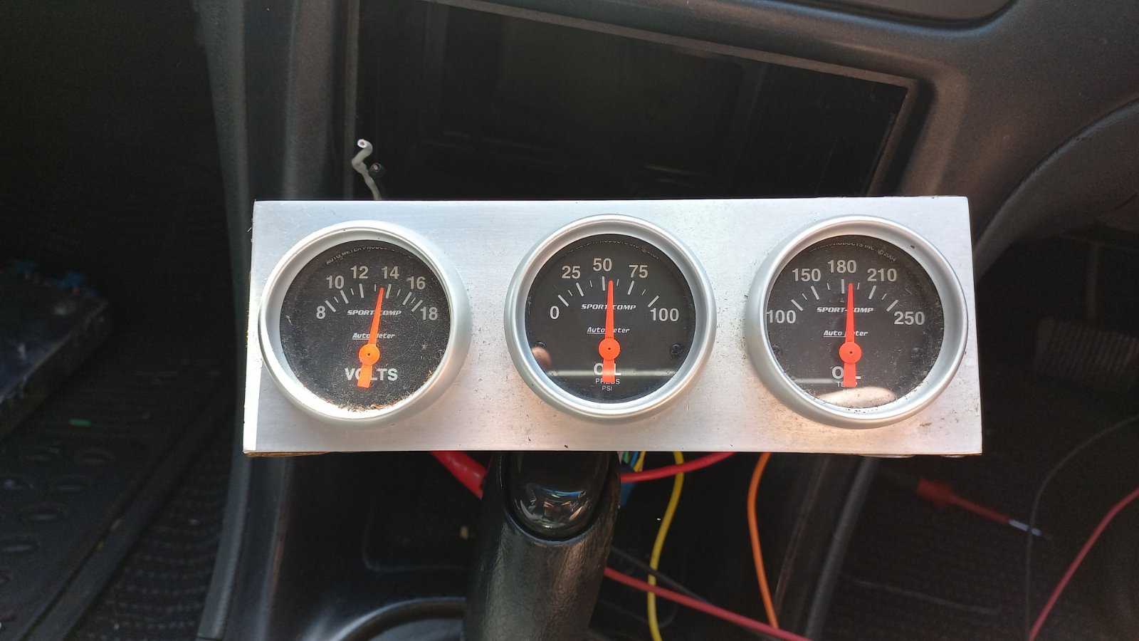

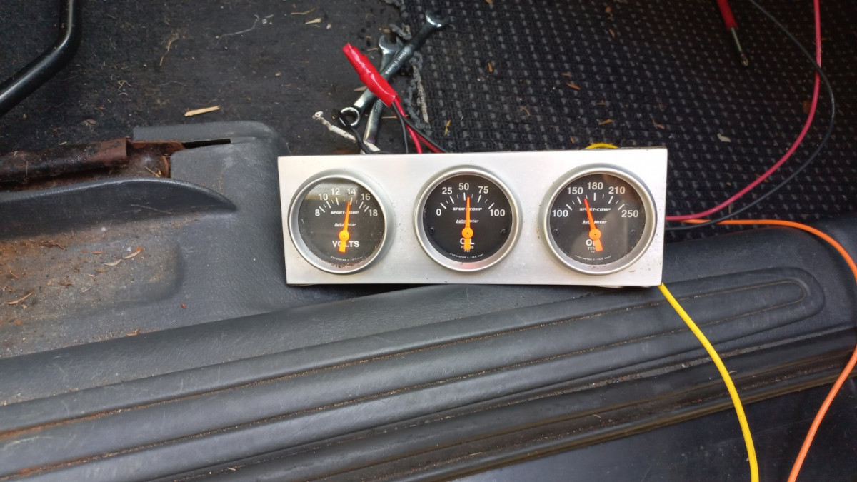

Re: Oil Temp Sensor Location? Stock ecotec oil temps?
Had a few little chores to do this morning.
After removing the LPG from the VT I had to bleed the cooling system but I forgot I was running the stock tune and managed to boil the thing
Put in a new tune this morning with lower thermofan settings and let it run up to check both fans work and check for leaks on all my fittings from yesterday.
Then I figured I might as well temporarily wire up the gauges and test the sensors. that's the old gauge cluster from the VN ( I do miss that car). The car has been idling for a good 25 minutes and the thermo fans have cycled 3 or 4 times including pulling the low speed fan relay so it could get hot to test the high speed fan. This is a 15w-50 Penrite diesel oil. It's got a lot of idle oil pressure considering I know the oil pressure bypass spring is a few MM shorter than it should be.
Let it idle for ages and even sat and revved it for a bit to 2500rpm, stopped and started a few times and moved my temporary wiring around a bit so I could close the door and bonnet.
Well at least I now know it's got plenty of oil pressure, probably to much really. I think it'll like going to a 15w-40.
I wonder how much difference that alloy sump makes to the engine oil temp?
Outside ambient air temp is about 16°C
