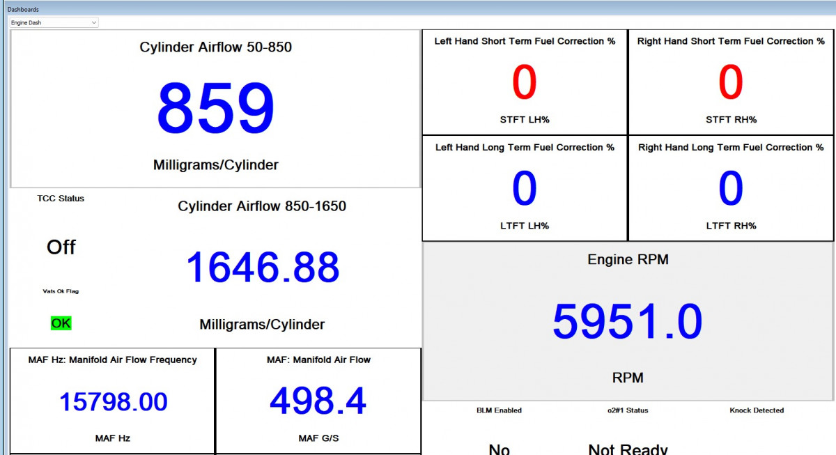

made some progress on VY Flash Enhanced.
Cylair is up and running, now to integrate it into spark and fuel with extended maps.
EGR is removed so this frees up room
C8 Pin is remapped for spare input for wideband or any 0-5v input.
Ive checked the 68hc11 for spare inputs and also mux chips but unfortunately that's it, there was room on the board for a second mux chip but holden never fitted it at U16
