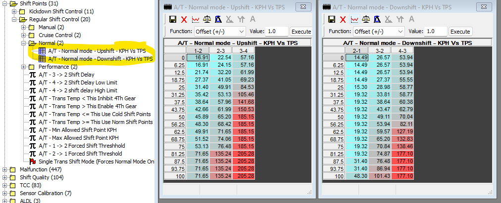

and is it as simple as sending "Mode 4 - Solenoid A and B off"?
Or do I need to dummy fill out the upshift and downshift tables with very low kph numbers to force it into 3rd gear?

looks like u could simply use the trans temps to inhibit 4th gear, then set your 3-2 shift to 40kph for the entire table.

I normally just roll into the gas and go full throttle once the dyno let's it go after the load in once it's got enough speed to not kick down.or you can pull the trans plug out and just rock full line pressure and only have manual 2nd and 3rd gear selectable by the shifter so it never downshifts lol

Thanks guys turns out the dyno operator didn't need to do anything and was just happy with the car holding 3rd gear by itself with the above settings.

Just pull the transmission fuse it will lock it in 3rd gear with full pressure
