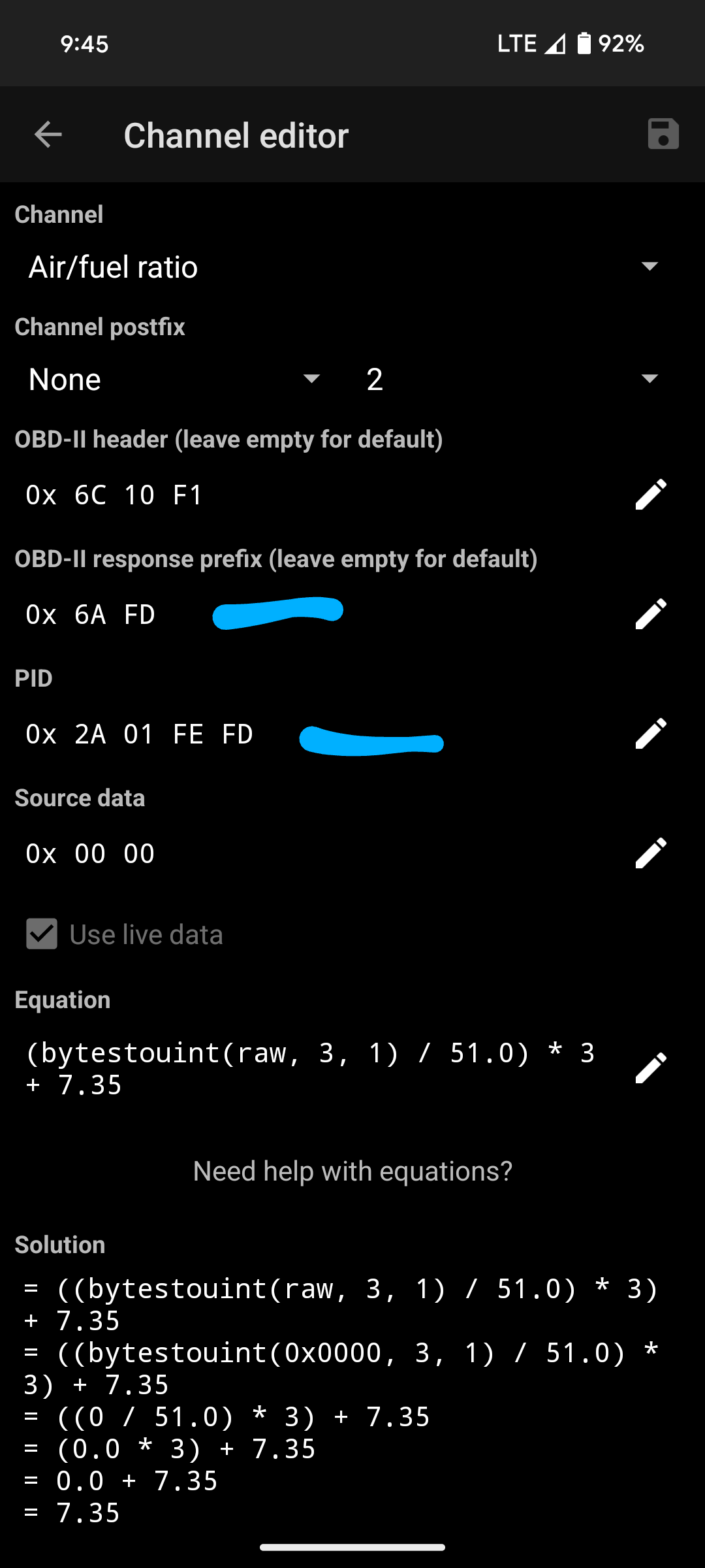

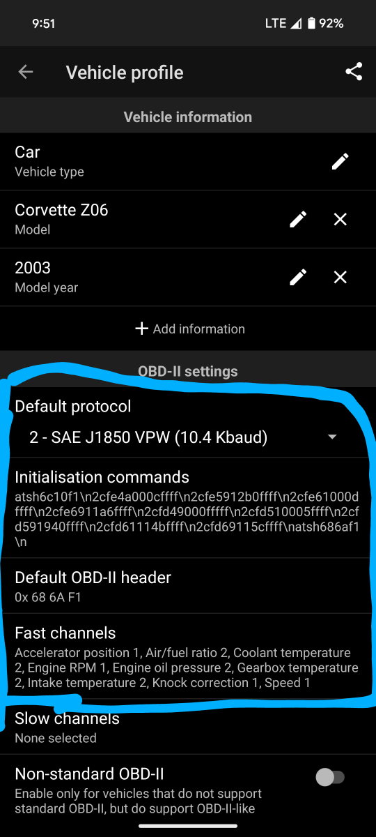

Best I've found is using RaceChrono, based on the effort from @jlvaldez. Simply because it's very customizable and you're able to build out and utilize 2C/2A logging, which helps boost the limited speed you can get elm327. Also torque sends a lot of extra commands (been ages since I sniffed the bus I don't remember details) which further slows it down.
In this example a total of 12 bytes or 9 PIDs are logged in location FE and FD, and RaceChrono is smart enough to send a single request and parse out all data from the response (if set up correctly of course). It is cumbersome to set up as it's an universal app, but once set up works well.
I forget exact logging speed details, but it was much faster than regular mode 22 single request/response. Can post more or help more next week when I'm back home, if needed.
