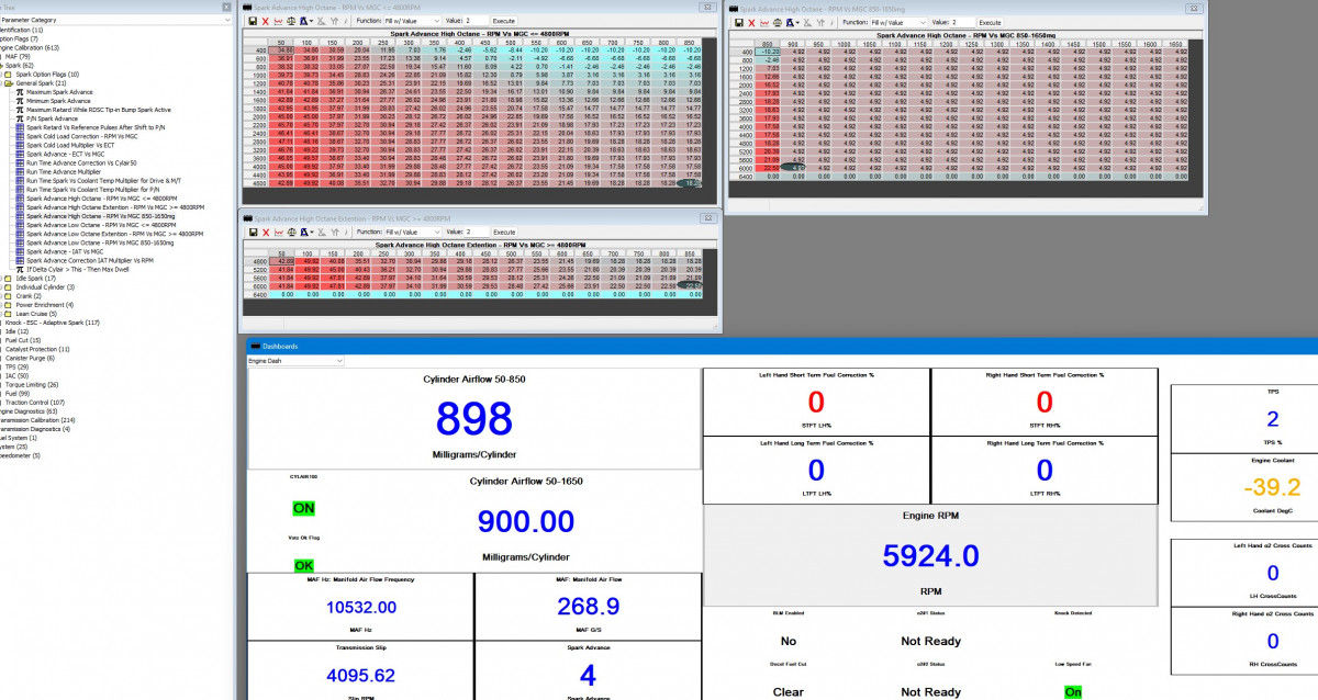

Cylair and Spark code working now, my brains a bit fried so will have to leave for a couple of days now, have run out of room for more tables, had to play tetris to try and fit the old tables in extended to 850 then jam in the new extra ones. So next challenge is to reverse some more code likely LPG and remove more tables from cal area to make room for injector table.

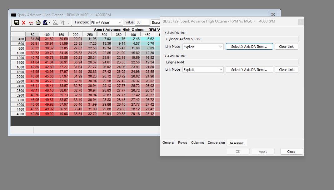

Easy as. I can’t recall, but do the flash pcms allow bubble tracing?
Posts: 4810
Re: VS-VY Enhanced Factory Bins
Everything can do bubble tracing, it just depends if xdf is setup for it. You can check a table if you try and edit it and goto last tab, with adx loaded as well it should show like this if it's linked, otherwise you can link it.
Wade has updated the vy xdf so depending on him if he's prepared to check it or not, ive done the new tables.
