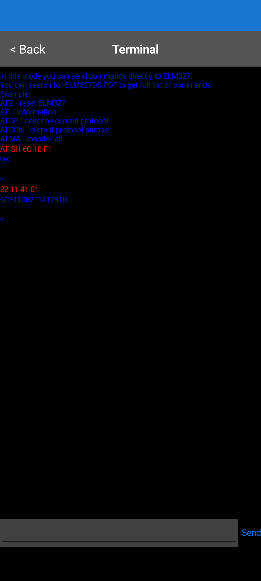

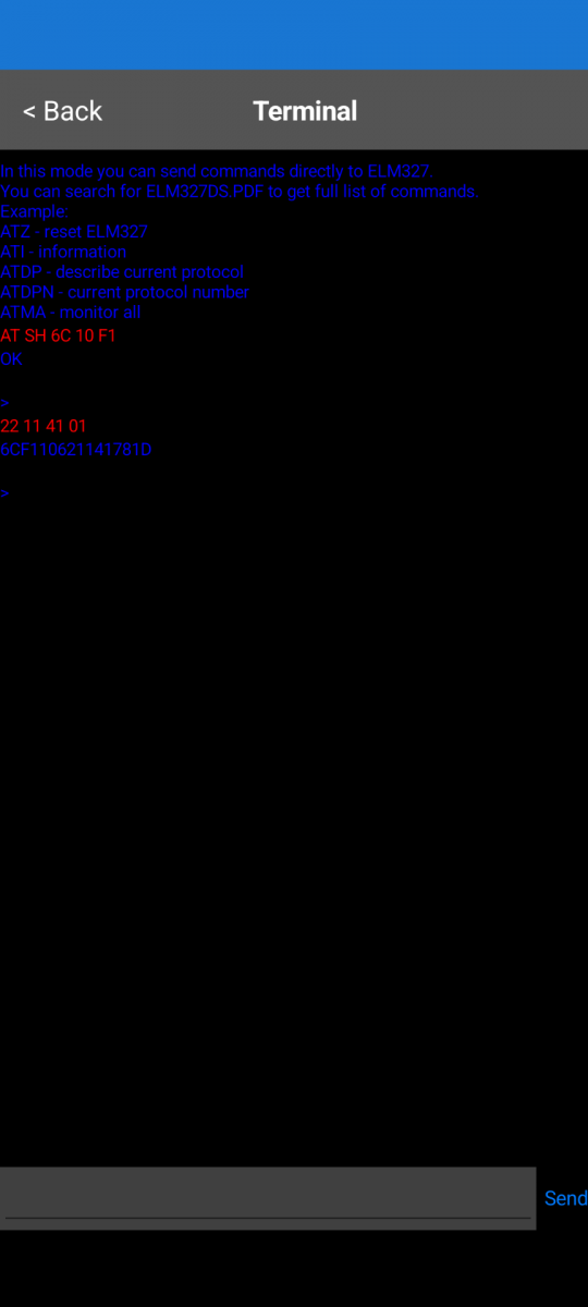

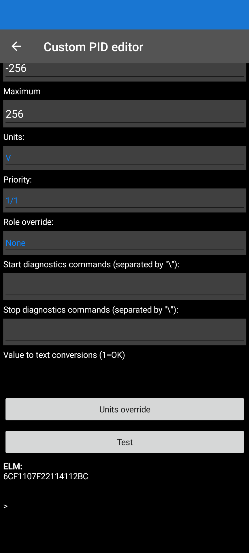

Antus, thanks for the link. It was a good video on how to setup logging data. I have also grabbed a copy of Car Scanner and it seems to work with the VX adapter. One thing I was trying to get working was reading GM PIDS. Specifically, one that I tried was transmission temperature since when changing fluid your supposed to check the level only after a certain temperature had been reached. I know the pid, and found an area where you could configure car scanner with a custom PID, then had a problem with how to get it to display. They have a formula section, but I want able to get it to convert the hex and show a value. Interestingly enough, if I use the terminal feature and manually key in the steps, I can get what appears to be a proper hex value out. Would be nice to get the app to show it directly.

Playing some more with the app. Just trying to get it to read the voltage using PID 1141. Just using their custom sensor option, I get a response of 12BC. Not right. But if I manually request mode 22 using the built in terminal feature, I get 781D, which I believe converts to 12.01 volts (correct).
Anyone successfully gotten the custom PID to work with Car Scanner?
