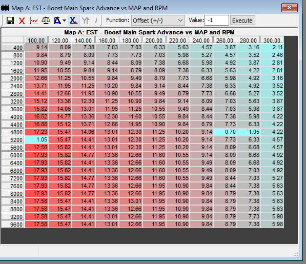

I am by no means a gun on any of this, but a quick look shows a few spikes in the ignition maps.
This is the boost ignition map, and there's also one crazy value in the 20 -100 kPa map at 85 kPa 5200 rpm. They could just be typos, and if they are, wouldn't cause the issues you are having.
Boost Igntion Map.PNG (65.33 KiB) Viewed 1157 times
I'm not sure what bin you started with, but there does seem to be a lot of Undefined items using the Difference Tool compared to BLCD.
I could be wrong, happy to be corrected, but if you start again with a new bin from scratch, and just carry over everything that is known, it will only cost you time not parts.
