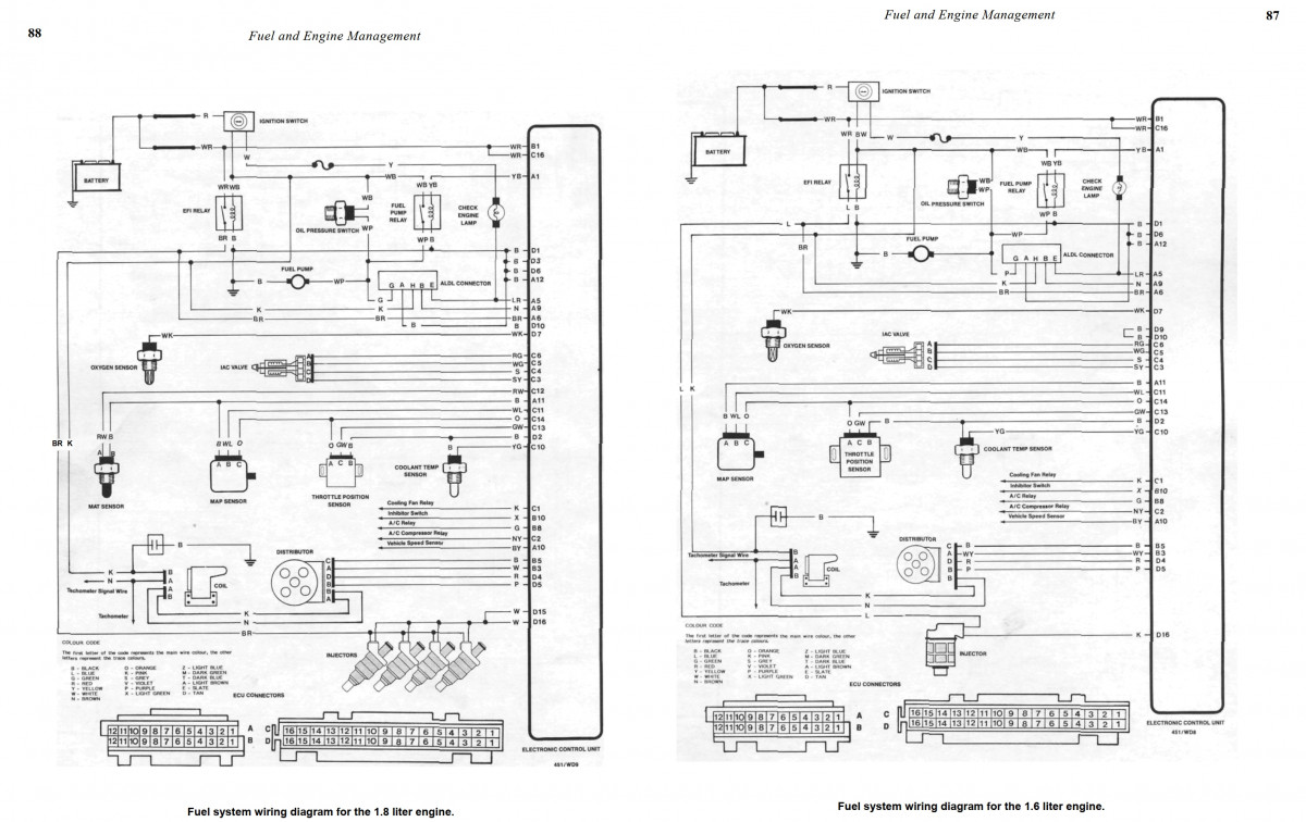

I've been using the very handy OSE12P JE Camira wiring loom pdf (thanks Antus!) as a reference during my conversion.
But with Camiras becoming very hard to find at wreckers, I used the much more common (and cheaper) N13 Pulsar loom, which uses different colour codes for the wiring.
So I put together a Pulsar/Astra version of Antus' pdf to save me having to cross reference two documents all the time.
OSE12P wiring - Pulsar/Astra EFI loom

Thanks for that, I added it to the official 12p thread next to the camira one

As this is probably the place to look for pulsar wiring details, Im adding TBI and MPI wiring.
