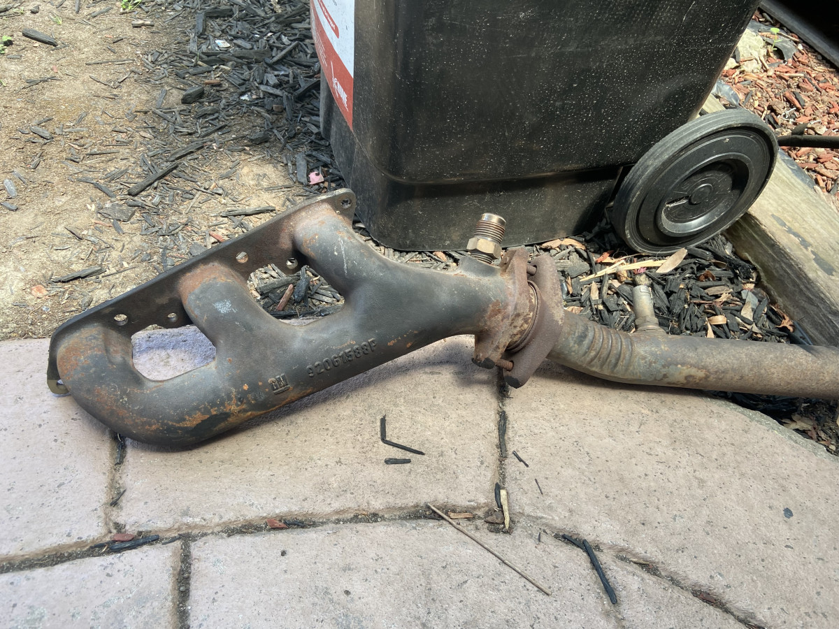

Update: found the ramp rate shift time tables and adjusted them in this latest tune. Was definitely the missing piece of the puzzle. Adjusting the desired shift times only gets you so far, but there’s still a bit of a delay on the 2-3 upshift. After defining the ramp rate time vs TPS that’s all fixed now. Shifts nice without even needing any additional pressure. Wasted $100 on a max speeding rods 44mm wastegate. But after a closer look, I won’t be using it. The old mvs tial style 44mm is what I used on the last build but that too wasn’t perfect. I think a gfb 44 is on the cards as far as the wastegate goes. Never used them but there definitely cheaper then a turbosmart gate. Also took a trip down the wreckers to grab an oem cast manifold. And started ordering some sch40 piping. Toying with the idea of trying to weld steel to cast iron 😂🤣. If not no big deal. Also want to try keep it all low mount. I know I’m making things harder on myself.
