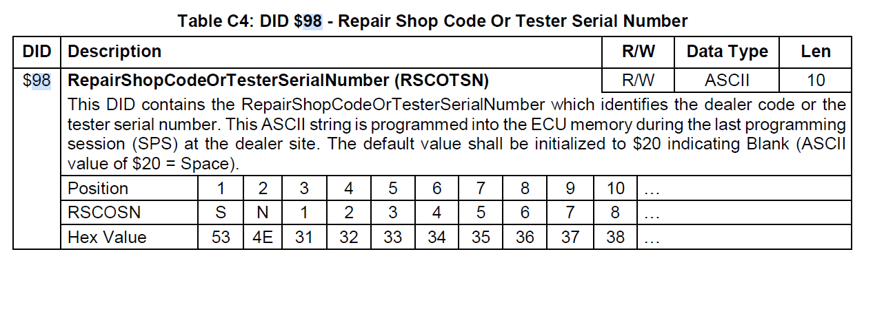

If your using a mdi you can enable logging with the j2534 configurator and get the 1a request that shows this 9999988888.
Since it's right before programming date I wonder if that's the shop code or S/N.
98 request is shop code/SN and 99 request is programming date.

Gatecrasher
Posts: 435
Joined: Fri Apr 24, 2020 8:09 pm
Re: e38 "Hardware Key Number"
Post by Gatecrasher »
That's the ID of the last computer to program it. The shop code if it was done by a repair shop, or the ID of the workstation at the assembly plant if it hasn't been programmed since it came off the line.

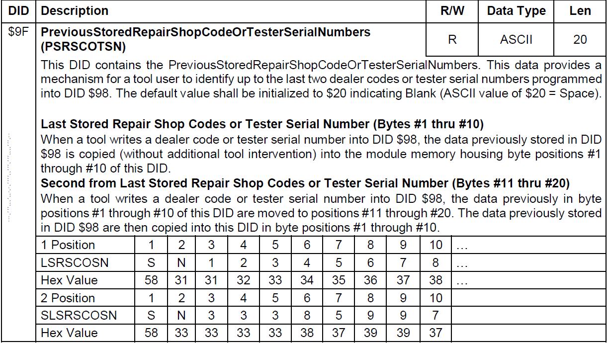

kostia111
Posts: 57
Joined: Sun Oct 20, 2019 6:58 pm
Post by kostia111 »
something like this

kostia111
Posts: 57
Post by kostia111 »
search the web
GMW 3110
You can write down your name or phone number
3B 98
any standard GM programming procedure
includes programming of DID 98 and 99
also the block usually stores the identifier of the two previous
programmings
