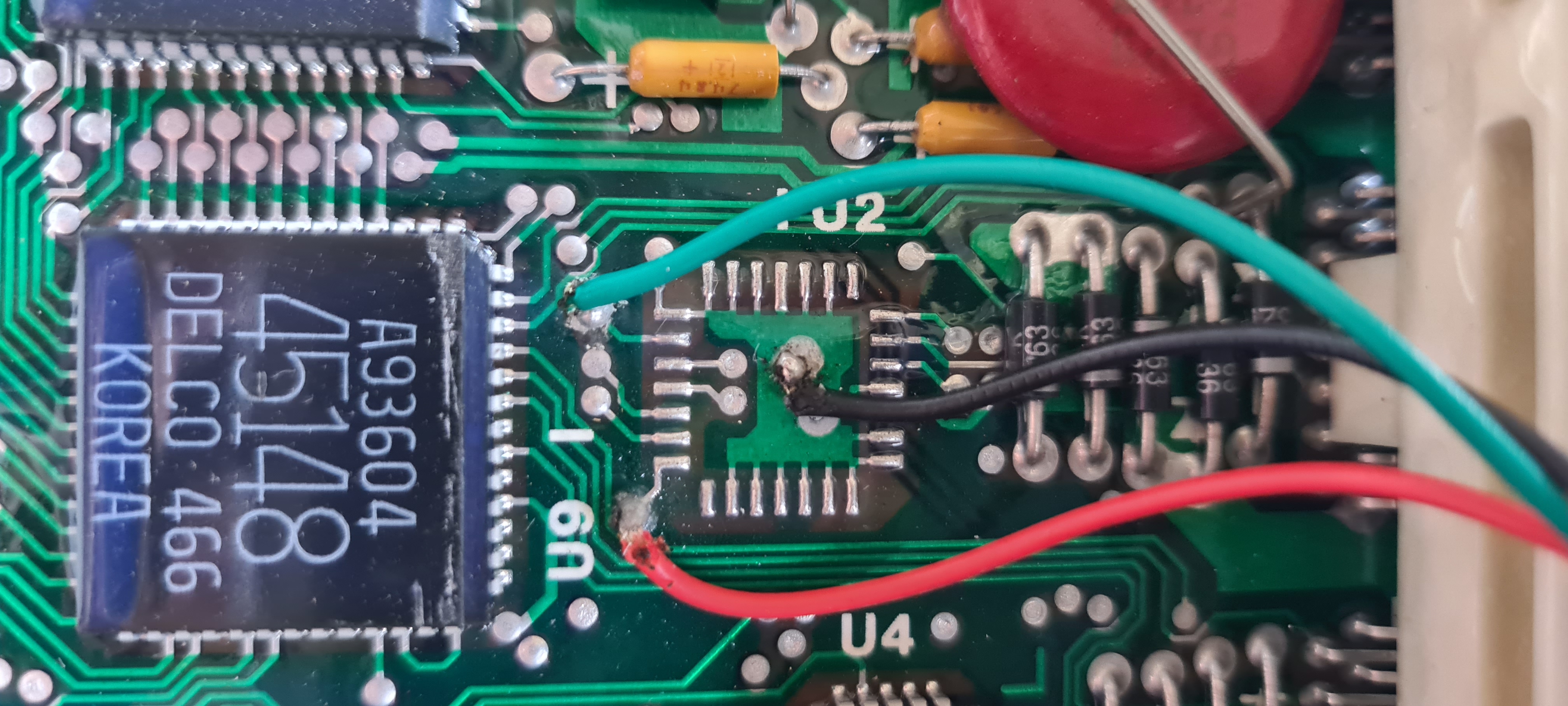

Blue light goes out as soon as i key off.
And there's a pic of the comms board wiring
Posts: 10111
Re: Help needed with Comms board & nvram
The wiring looks good. Light going out straight away means the 12P software is corrupted and not running the ECM. You need to use a programmer to put the stacked 12P bin file on the nvram chip directly to get the computer running first, then you should be able to talk to it over USB.
