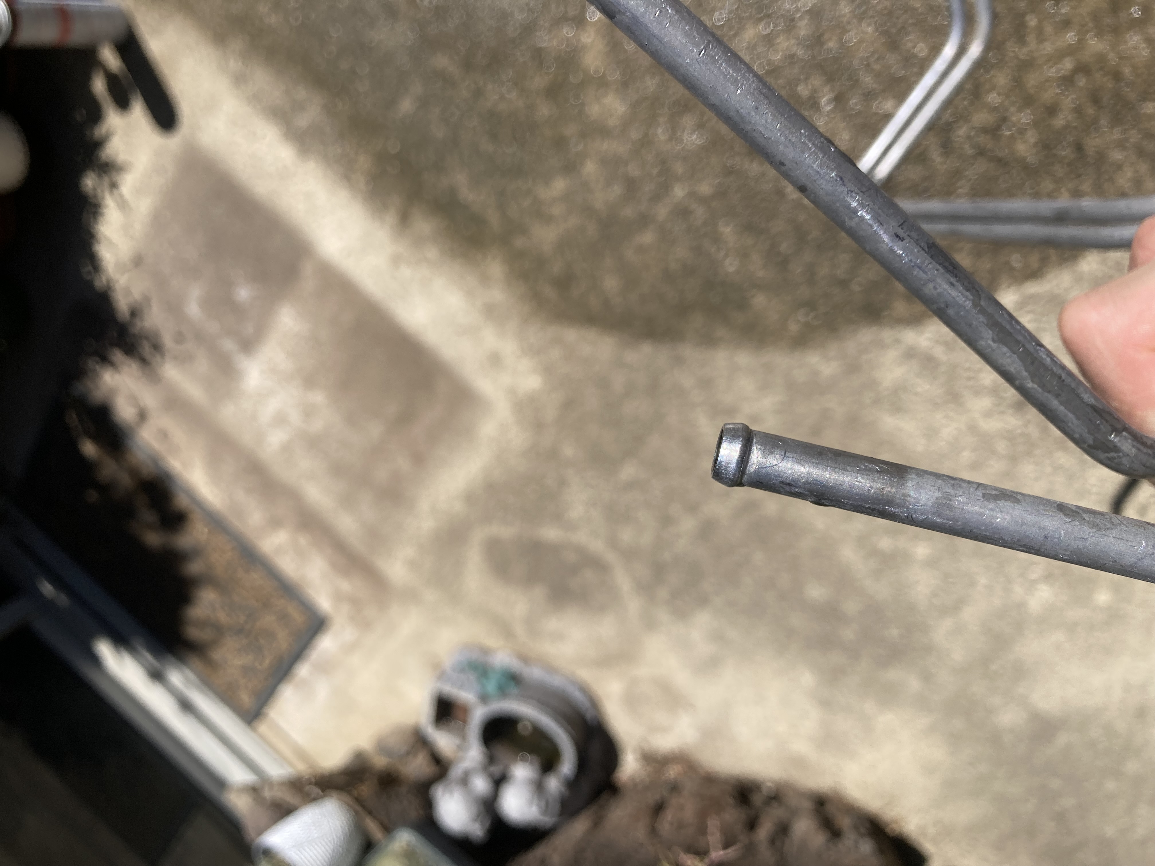

I need these done, no flare nuts or anything, just a bead, barb if you will.
Still haven't found anyone yet that can. A few people have said they don't have the nuts for 3/8 but I am not sure how bead turns into nut? But then knock back the job anyway without saying if they can or can't do it. Frustrating. Feels like a repeat of the laser cutting jobs from a few year back.
But at least I have my sample pieces to copy from into the larger 3/8 pipe.

I know Enzed don't, haven't tried the other mob though. I've asked in store 2 years ago when I was getting a pressure washer hose and some bits, which never worked right btw, I asked about some various car related stuff including this while I was there, they suggested fittings to adapt back to barbs.
I am almost thinking that half doing an inverted flare might result in a shape close this this? It might be worth investigating.
If I had a real income I would just buy the parker aircraft tools and be done with it, then I can do the entire hardlines of the whole car when the time comes, but I am poor now and can only afford 50-100 bucks a week or so if I really try and be tight on everything else and get lucky as most of that comes from selling off small parts of low value on ebay every blue moon or so, that is all going into this car to get it on the road, as I only have about a year before the properly sells and I have nowhere to undertake such large projects or jobs anymore. The parker tools are something like $600, the machine that does that exact bead is about 30k, I know as I looked it up and found the machine long before the hand tool. The beads are actually a bit different if you look closely between the two methods.
I figured someone that works with hardlines much have at least hand tools somewhere.
