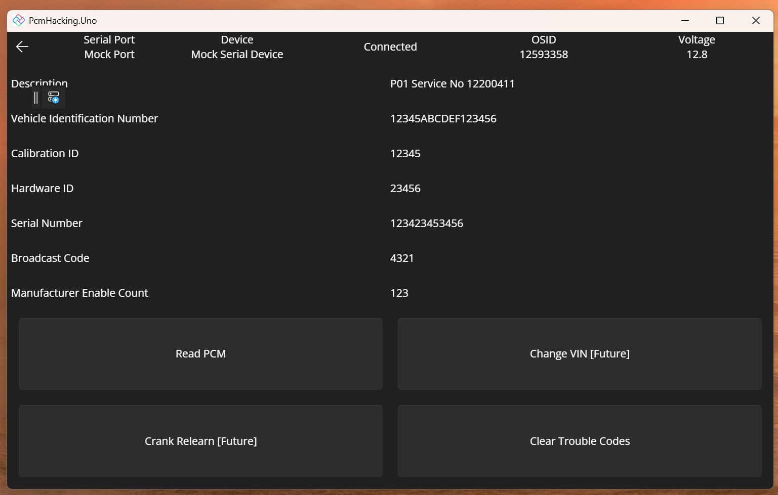

I want to have the app poll the OS ID and voltage a few times per second when the user is on the main screen, so the top right corner can indicate whether we have a connection to the PCM. (Also, turn the voltage box red if it's below some threshold.) That initial polling would also pave the way toward showing the appropriate set of flash options on the write page, or a "choose your PCM type" step if the OS isn't recognized.
If the user clicks Special Functions we could read and display the properties on the next page, and below that have buttons for Read Codes, Clear Codes, VIN Change, Crank Relearn.

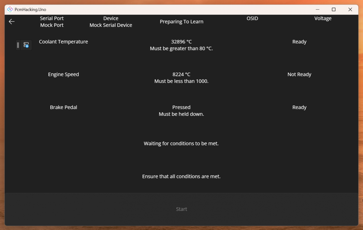

Re: .Net 8, cross platform, and Windows 7/8
I have it basically working with the Uno Platform UI now. It still has a lot of rough edges, and nothing about the UI is pretty, but it's able to select an interface, read, write, get properties... and I hope to get crank relearn working this weekend. Data logging is going to take a lot of work though, so it's going to be slow going from here.
The screenshots below show fake data, but only because I'm too lazy to go upstairs and connect to a real PCM.
And I just noticed that it's showing RPM in degrees celsius...
