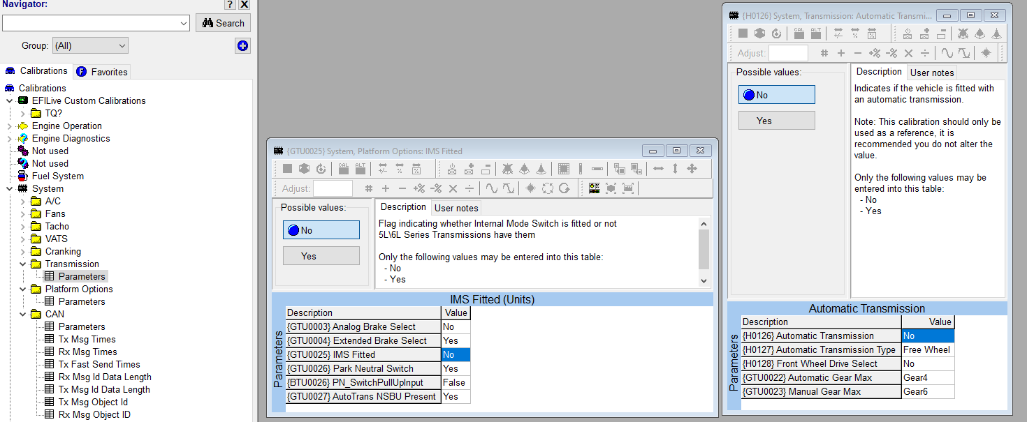

Ok. So we have a compatible E40 ECM (05-06 GM LS Gen IV) to T43 (6L45-90) basic "drive" solution. However, we have a tag-along problem that we didn't anticipate, the PRNDL. Apparently, gear selection signal codes are drastically different and inherently programmed into the CANbus communication (i.e. ignores usual IMS and PNP signals). Sooo, anyone out there who can either suggest a solution or personally do some core rewrite of the T43 calibration to align the T42 IMS signal to the expected T42 PNP signal?

probably need someone clever enough with ghidra to decompile the relevant t43 & t42 os/cals to work it out.
i'd be keen to hear more, i've got a a 6l80e/e40 combo in a mates car via pcs controller acting as the middle man. Was originally a manual though so dont need to worry about the t42.

so small update. new harness is on. modified trans tune to show up gear shift positions correctly. flashed update to ecu with new cal settings.
ecu no longer responds to programming or scanning, but it still transmits on the can. no idea wtf has gone wrong there. so have cracked the case open to bdm it back to an old bin file.
when i get it back flashing via can, im going to flash the same file back in and see if it happens again. if it does, process of elimination to find out why.
it's like ive turned on a "do not respond to can tool messages" feature...
I even double checked all the addresses & code structure in ghidra compared to e38 and everything looks to make sense. I suspect I will need to change the tcm to an older pre 2009 model still.
