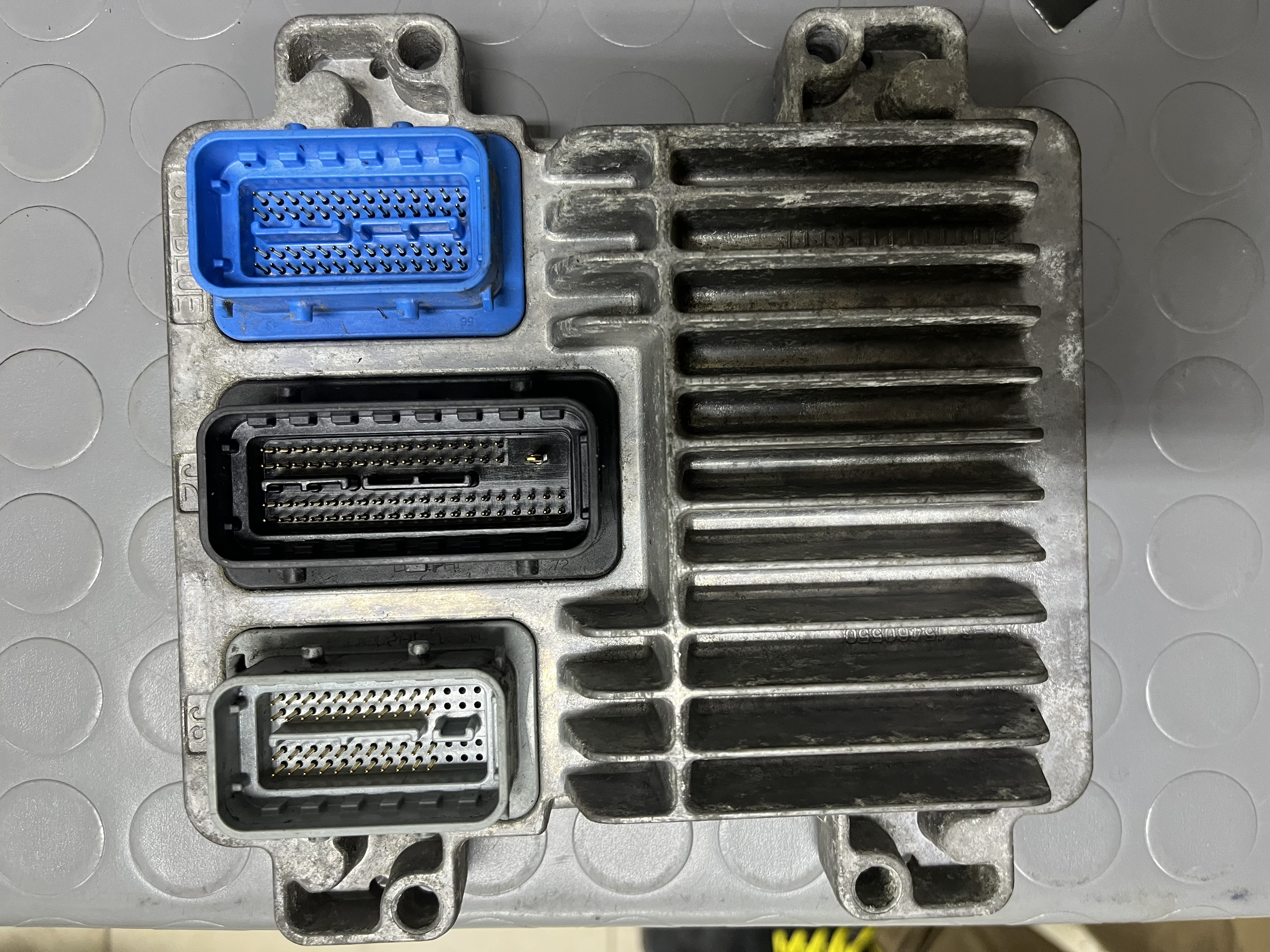

got it work... think was bad connection.
new problem. here's data log.

- Posts: 8996
Re: PCM Hammer Release 021
Nothing at all coming back from the car. You've got battery power but check ignition and data wiring.
Using bench harness. Thought so and plugged into hpt and was able to read. E40 ecu
E40 isn't supported by PCM Hammer.

Hello everyone and congratulations for the forum. I searched for introductions/presentations section but I could not find it, so I apologize if I am making a mistake according to the forum rules.
My name is Davide and i'm writing from Italy, the work you have done to allow the reading/writing of the GM group control units is it fantastic! I found your forum because my friend bought a 2006 Hummer 3.5L with VATS problems and I would like to try to read the PCM to understand if it is possible to deactivate it in some way. To do this obviously I downloaded pcmhummer 21.2 and I tried to read the ecu but I received error related to the HW ID because the control unit was not recognized as P12 (log1 in attachment)
So I tried to modified the code (I hope I did it right, I'm a beginner) and added the ECU reference first in P12 1mb (log 2) and then in P12 2mb (log 3) but in both cases I can't read the ecu, can someone help me understand if and what I'm doing wrong? why can't I read the ecu?
In attachment logs and ecu pic.
Thanks a lot.
Thanks a lot.
