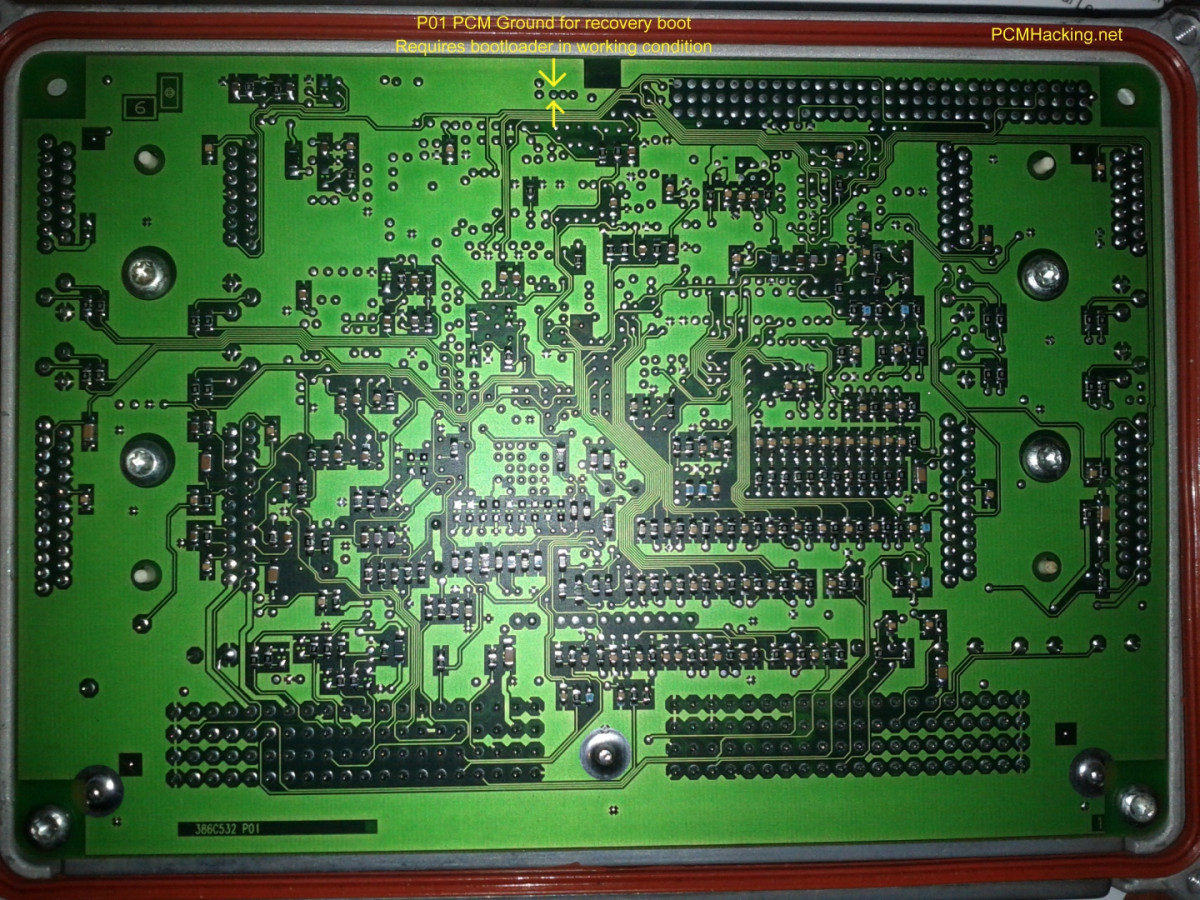

P01:

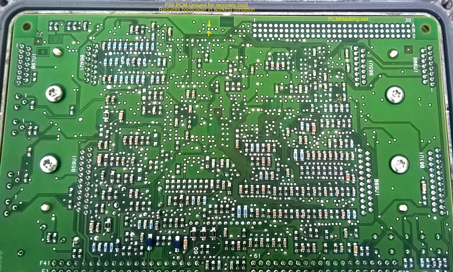

P59:

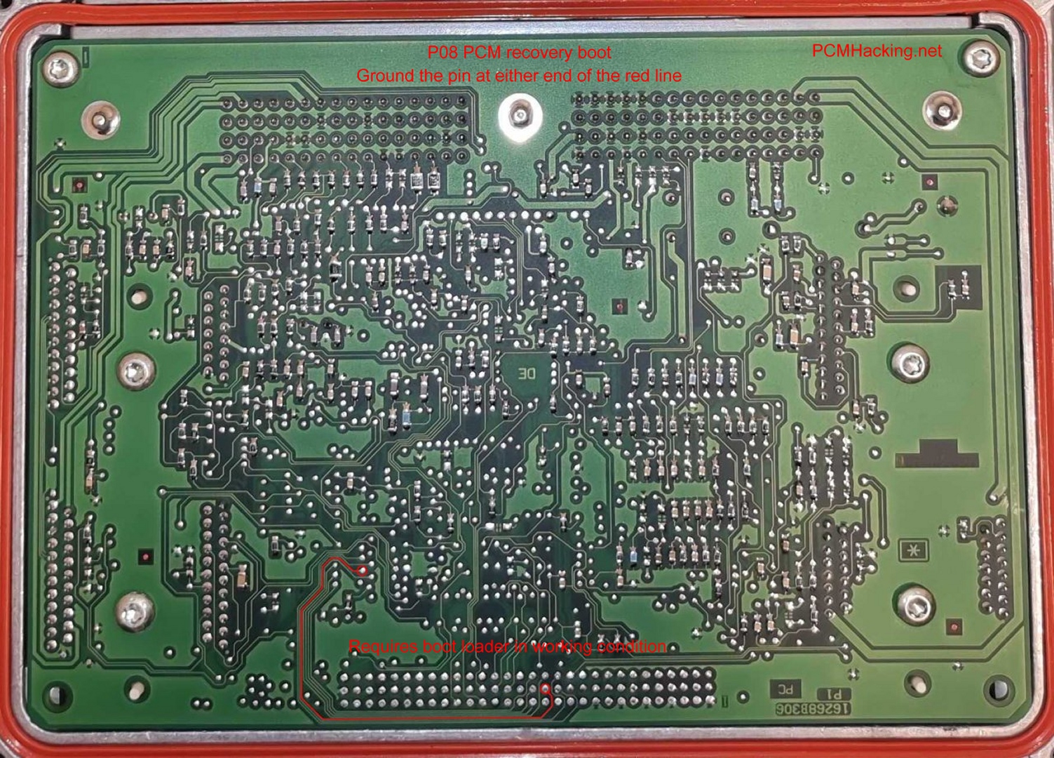

P08:

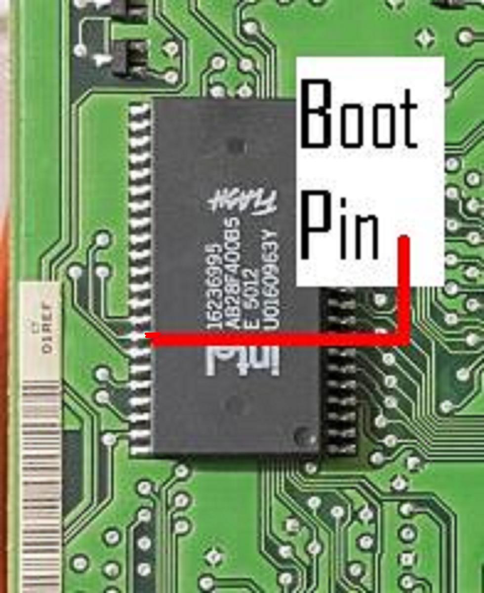

Edit,
Another P04 pic, intel.

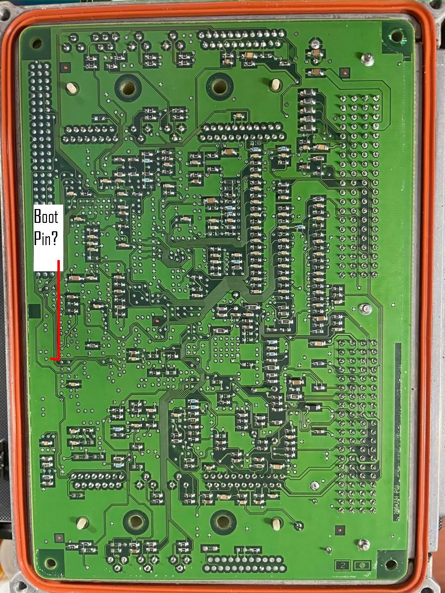

Edit2:
Found some E54 screens.
I have a folder on one of my laptops with more unlock pin screens, i'll have to go digging I guess.
Haven't yet had the chance to test any of the above, though when I found them, was posted as having been tested by the original poster of the info.

I have successfully unlocked a e54 with this method. Can confirm that the photo is correct.

P08 Ground Pin that has worked for me

The P04 is the correct Ground Pin I’ve used it many of times.
Is there a certain way of doing it with the p04? It didn’t work on either of my PCMs with bad flashes. I’ve done it twice on my p59 pcm so I assumed the setup was the same.
Edit: One week later tried again. This time it worked the 3rd attempt. There must be a window of when to release the ground that I was missing or got lucky on this time. About to try my other brick.
Edit 2: Second PCM worked on the 5th attempt. Not too dissimilar to the first one, but different enough for me to not be able to tell what i did right or wrong.
