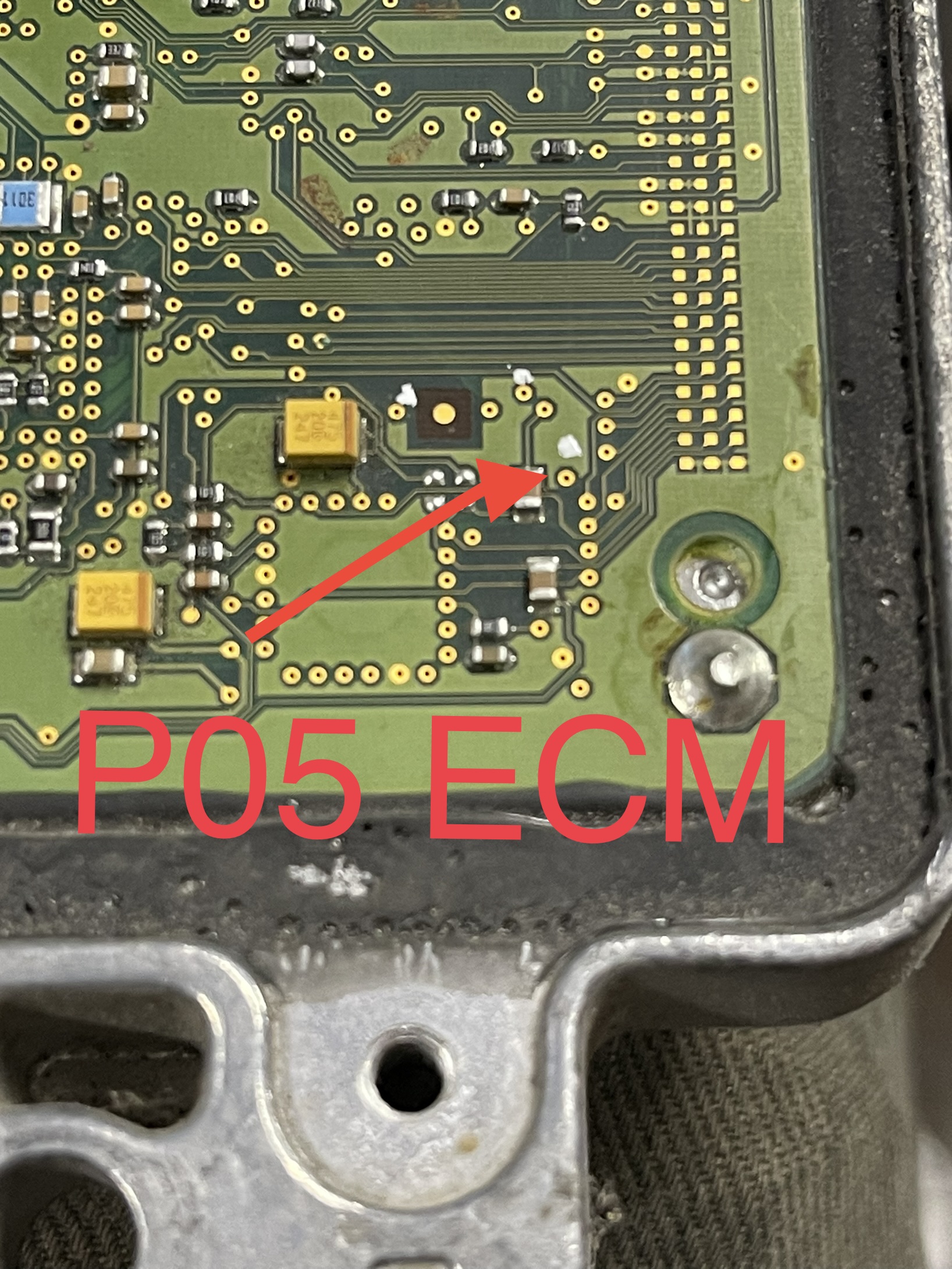

Backwoodsracing
Posts: 23
Joined: Mon Apr 05, 2021 2:04 am
cars: I have 4 w-body’s 2 Silverado’s 1 Yukon 2 cavaliers
Re: P10 and P12 Primary CPUs
Post by Backwoodsracing »
This one worked for me on a P12 that got bricked with pcm hammer. It’s the same for the P05 as well. Hope this helps.
This is P05 I posted the P12 one in the Pin out section, sorry I had them backwards.
