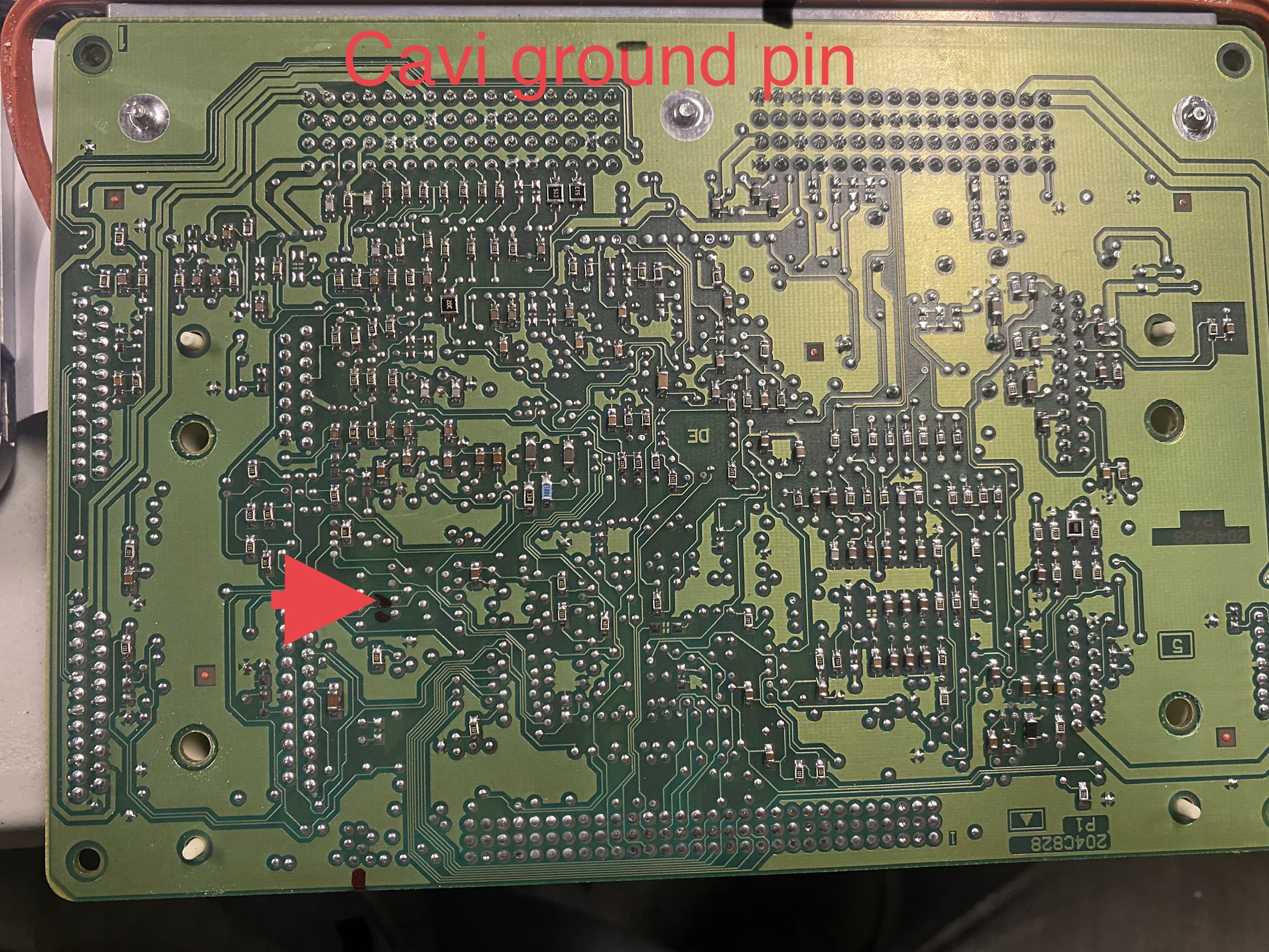

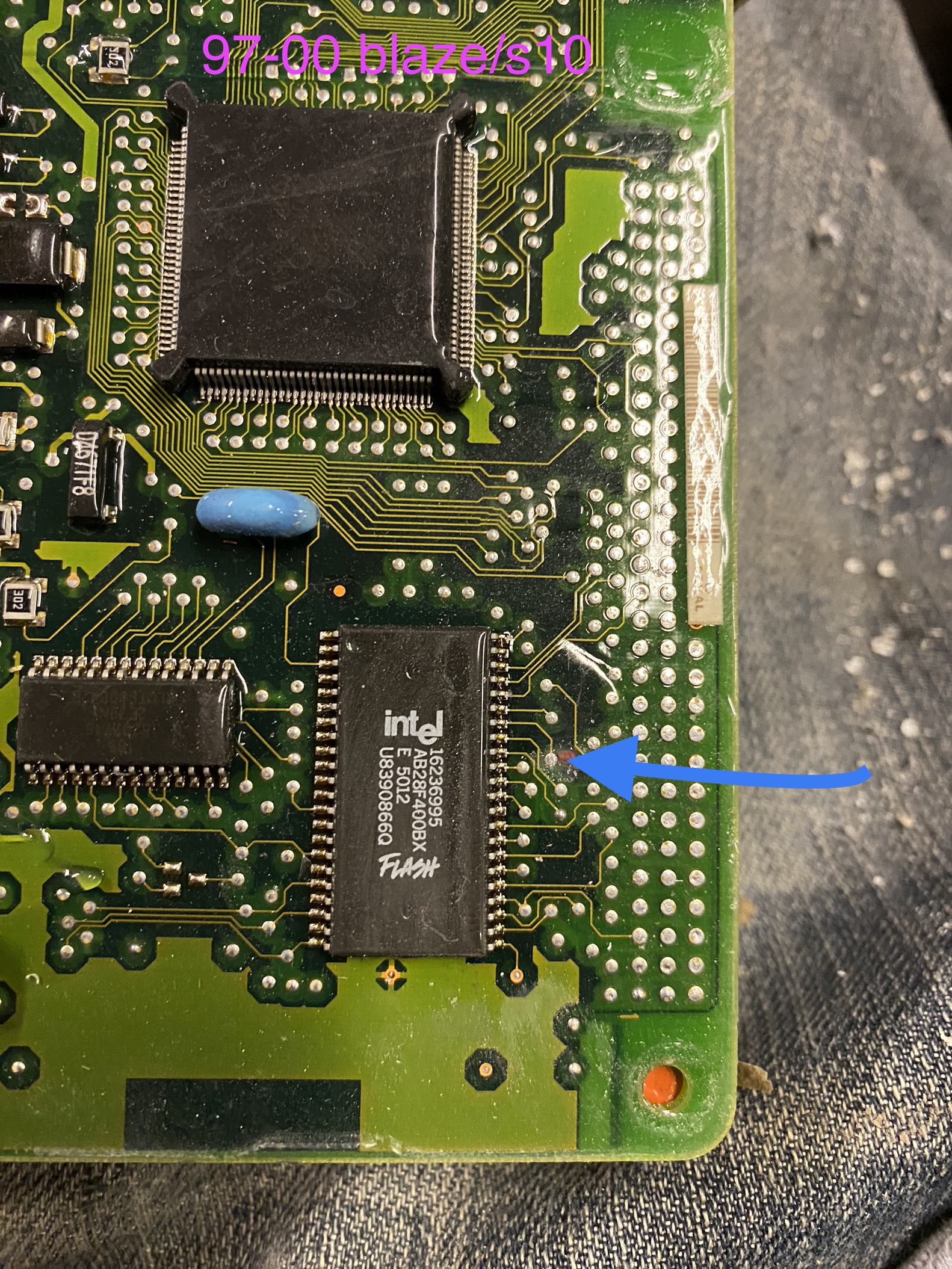

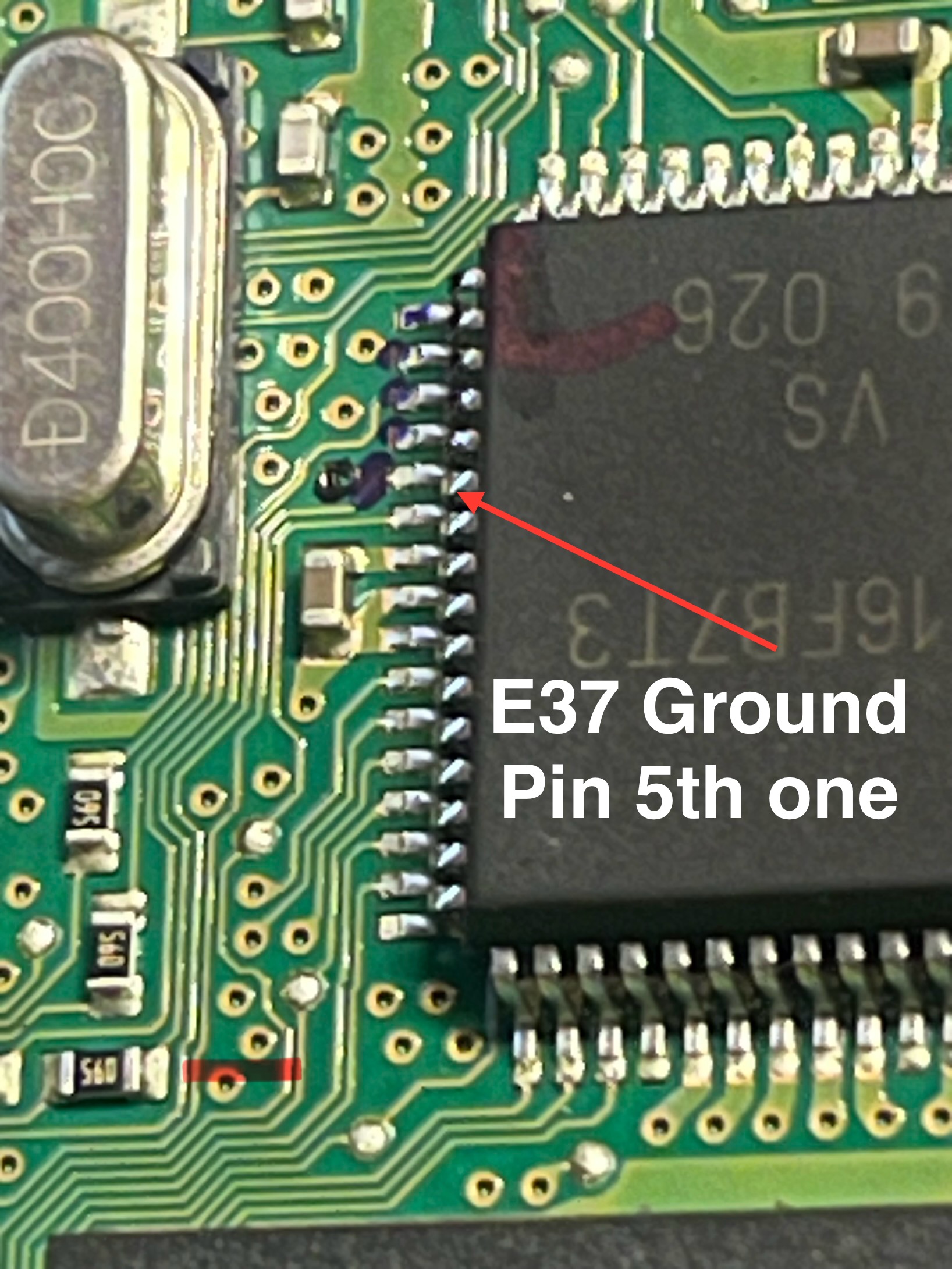

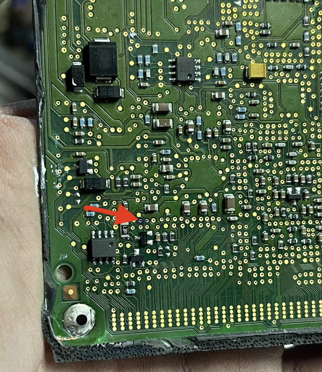

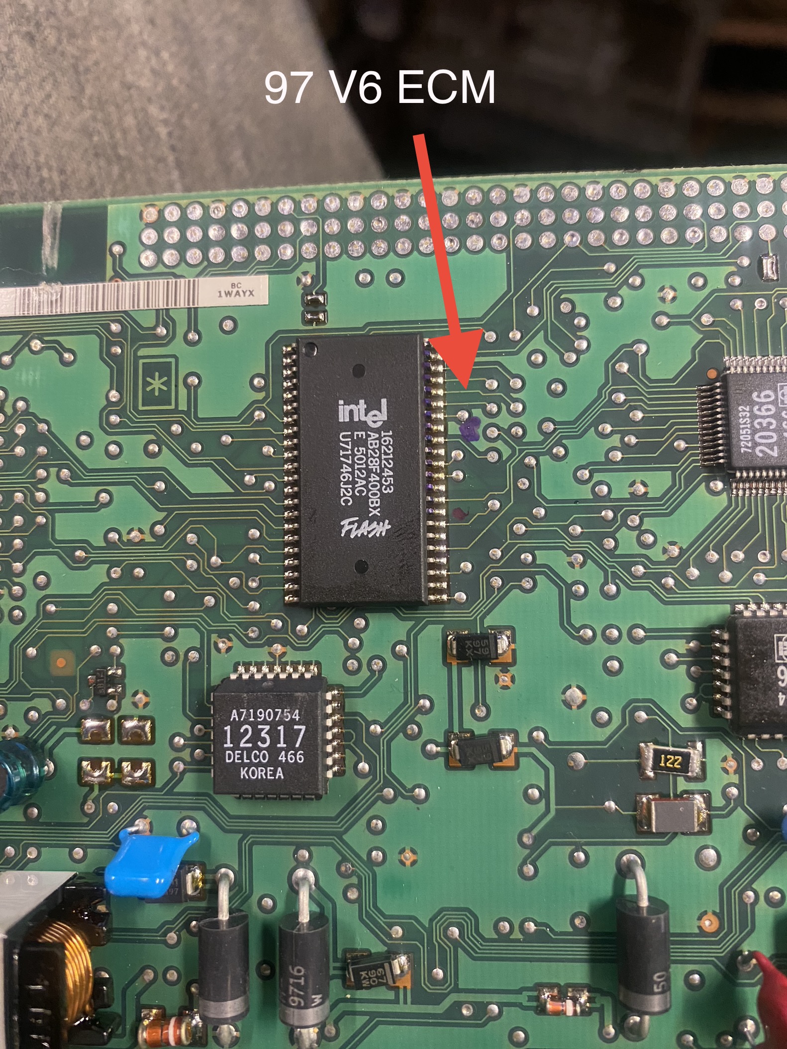

P08 Ground Pin that has worked for me
P12 Ground Pin
E37 Ground Pin
97 V6 Car
Black Box Ground Pin
Last edited by Backwoodsracing on Tue Jul 01, 2025 9:29 am, edited 2 times in total.

The P04 is the correct Ground Pin I’ve used it many of times.
