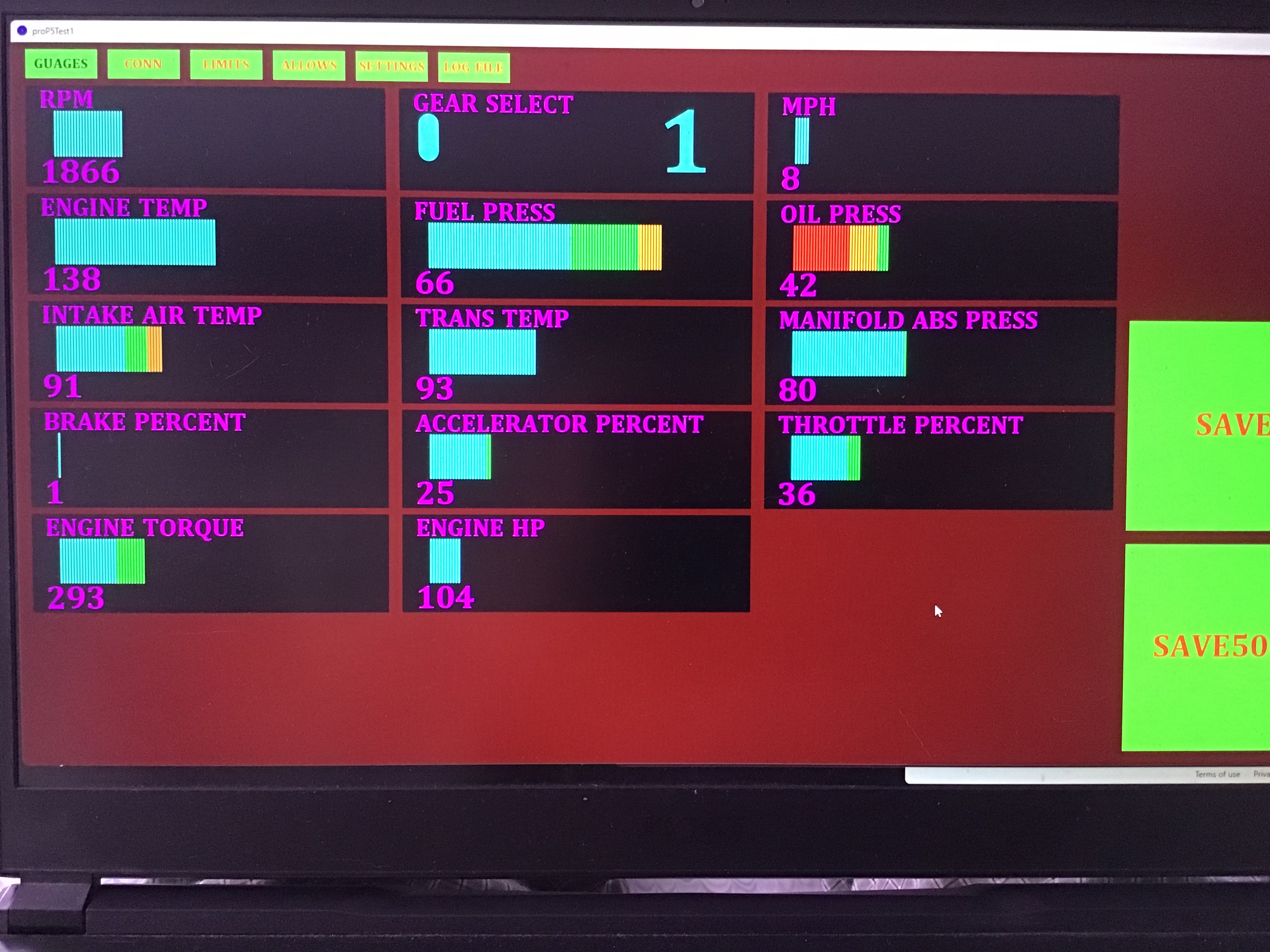

I started a project to use an Arduino to connect to my GM vehicles. The software I’m developing will be able to record and play back logs, be a dashboard, and trigger outside power adders such as nitrous, methanol, or charge pressure blow off valve systems. I’ve been able to just learn about broadcasted data so far and got most of what I need but I can’t get the MAF through broadcast data so I will soon try to poll for it unless I’m missing something. Does anyone know if MAF data is broadcast? I’ve gained my knowledge so far using some GMW docs and trial and error. Here is a pic of a data log and short video of a playback of it.

I added a screenshot here as I can’t view the video so maybe others can’t also.

I don't think there are any broadcast MAF airflow values. That would be internal to the ECM for its torque modeling. I can't think of another module that could use raw airflow for anything. Probably going to need to poll the ECM for it.

Post by Canticicant »
Thanks Gatecrasher. I haven’t tried polling yet so that is my next quest. I have a obdii diagnostics reader that can make a custom list for real-time data viewing and it can display the MAF data so I will plug it in with a obdii splitter at same time I read a log to get the packets that I will need to transmit with my Arduino. I’m just thinking out loud here, thus the run on sentence. Does this sound like a correct way to achieve my goal?
