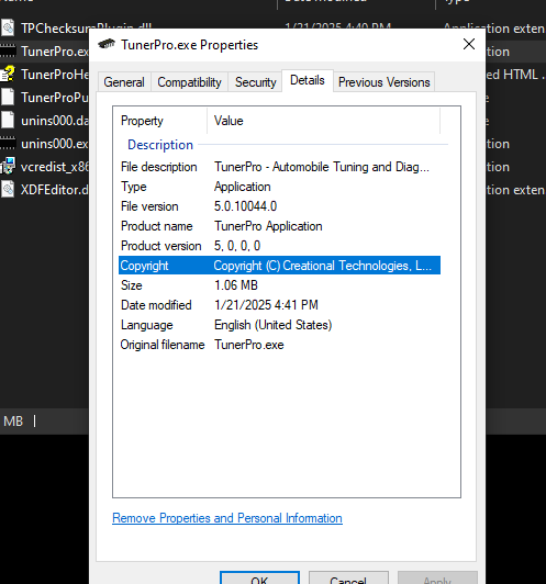

Denny wrote: Tue May 27, 2025 3:27 am Hi, I read this post awhile back. All above my head, but very interesting. Does it look promising??? Thanks.
The stable output I'm seeing on my oscilloscope at 23,000RPM, says it's promising.
Other than adding temp to the main code, it's to the point it can be tested on an engine. Not race test or anything, just run something and show it doesn't explode.
I need to get TunerPro or similar to interpret "TuneArrays.h" file for adjustments to not take hours of typing.
ChatGPT tried instructing me to use Python to convert the file into a correctly parsed .bin, and gave me XML that fails to load as an XDF, with no errors... just silently fails to load anything.
https://chatgpt.com/share/68355c86-3a14 ... c819f3d9c0 That specific AI chat.

What I would recommend doing:
1) Make a bin file and manually defined what each table/parameter is stored in Tunerpro.
2) Copy your current arrays from your sketches into the bin (use AI for this, ask it to insert "X" array into the bin file at "X" offset.
3) After making your edits in tunerpro and saving the new .bin, use AI to take "X" bytes from the bin array at "X" location, and to then create it into the byte array format that you use in your sketch.
Step 1 and 2 should only need to be done once.
Step 3 is what you keep repeating as you edit your bin file and put back into your sketch.
Alternatively, you can save the entire bin file as a "static" byte array in your sketch so that it stores it into flash (And not ram).
Which means you could only need to get AI to convert the bin file into a byte array, then you can get your sketch to pull all latest updates from that bin file.
