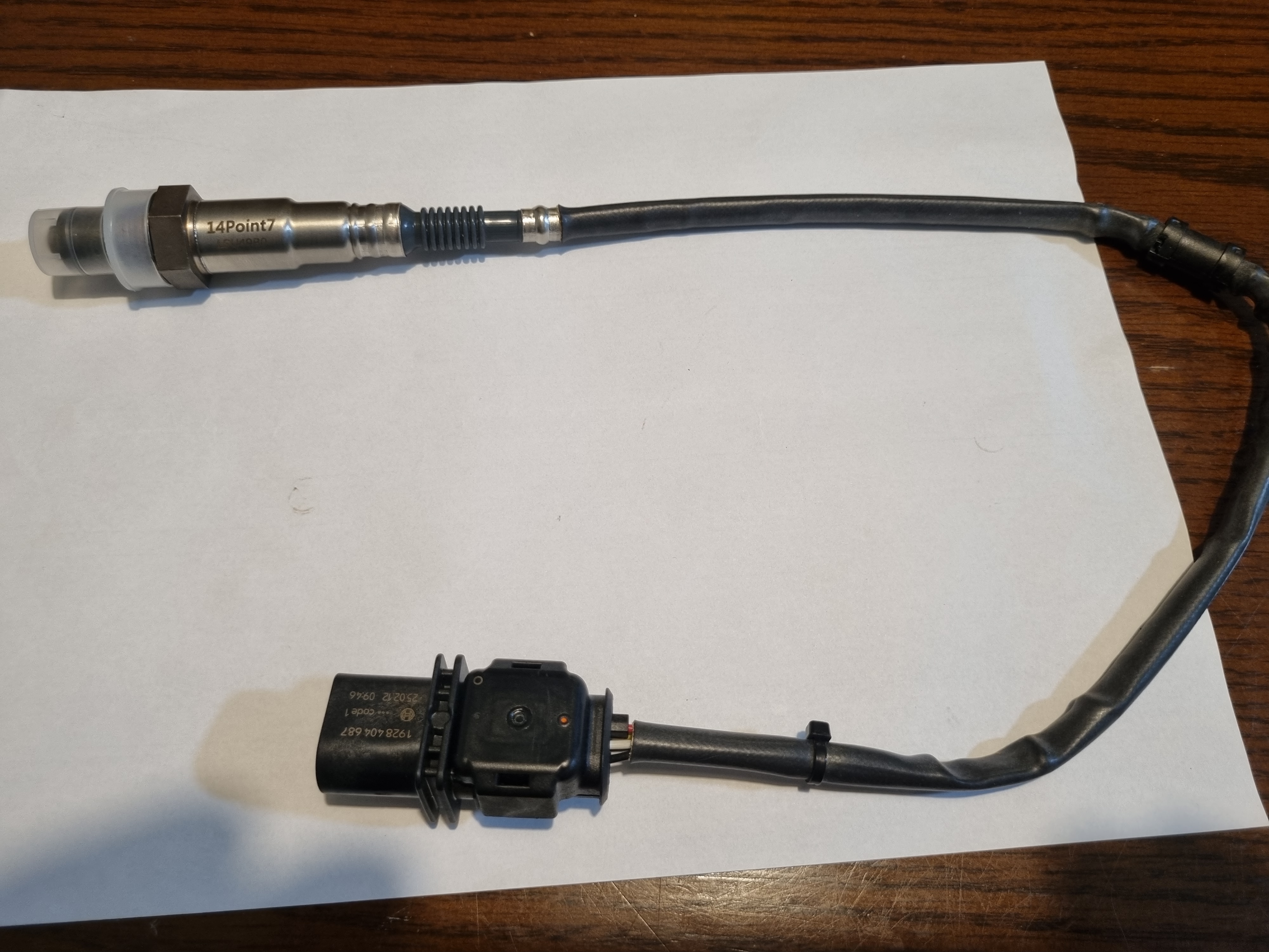

Does this look like a genuine bosch sensor?
Posts: 8548
Re: Wideband recommendation
I very much doubt it.
Posts: 10013
Cant say for sure but I'm with vlad. I'd expect it to be bosch to start with, not "14 point 7". I did actually have a 14.7 kit back in the day and the sensor was not marked like that. The sensor seems to have a 2012 date on it which would pre-date more modern verification, but it looks brand new. The only way it would be legit is if 14point7 the company got a batch specially made custom and its been sitting on a shelf for 13 years. Not absolutely impossible, but not expected.
Bosch stuff usually uses holograms and codes such as https://www.boschaftermarket.com/xc/en/keysecure.html
But even then they seem to have an app now, so I don't know what has changed. I dont know if they use it on their automotive parts yet, or will do. https://www.bosch-origify.com/
Generally speaking the only way to get a genuine sensor for sure is to go to an official OEM supplier or absolutely trusted store, but even then they make mistakes.
I havn't looked at it for a while but I believe many more modern cars have bosch widebands from factory. If you did a bit of research you may be able to pick a car and get one from the wreckers, too, but you'd still have unknown condition.

Yep Ant/Vlad that's about what I thought as well.
New sensor arrived last week from 14point7.
I queried Alan at 14point7 as to why there is no bosch part number on the sensor body. The answer given was that he gets them straight from Germany pre branding and has them made to his spec.
No way to confirm any of this as they don't carry Bosch markings.
To my query Alan then told me he does not want me as a customer and to smash my entire order up with a hammer, send him a pic and he will refund. Not that he will address the sensor issue, offer any replacement or refund or further evidence of quality.
