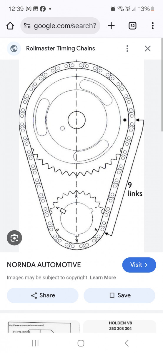

You didn't set the cam dot to dot by any chance.the dots go 9 links apart the chain normally has 2 different coloured lnks for the timing marks
Asho88
Posts: 44
Joined: Fri Dec 13, 2024 3:32 pm
cars: Vh Commodore 253 looking to convert to fuel injection.
Re: VN V8 timing
Post by Asho88 »
Yeah I did set it to dot to dot.
brindo
Posts: 287
Location: Western Queensland
Re: VN V8 timing
Post by brindo »
Dot to Dot?
Or 9 links?
Asho88
Posts: 44
Re: VN V8 timing
Post by Asho88 »
Both. The dots are 9 links apart counted them. Anyway update moved the battery from the boot to the engine bay and it starts on aerostart now! Seems I have injector pulse but no fuel so I’m gonna to get a new gauge cause this one was a cheap on and I don’t trust it then start working on the fuel system hopefully it’s just adjusting the reg. Definitely fuel getting to the motor.
