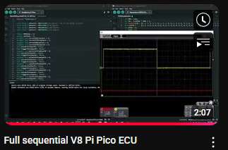

https://www.youtube.com/watch?v=UCtbsBIIFGY

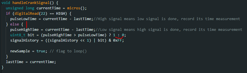

Minor readability change for anybody keeping track.
Swapped the low and high name and inverted the "if >" result.
Purely a readability change. Explained by comment.

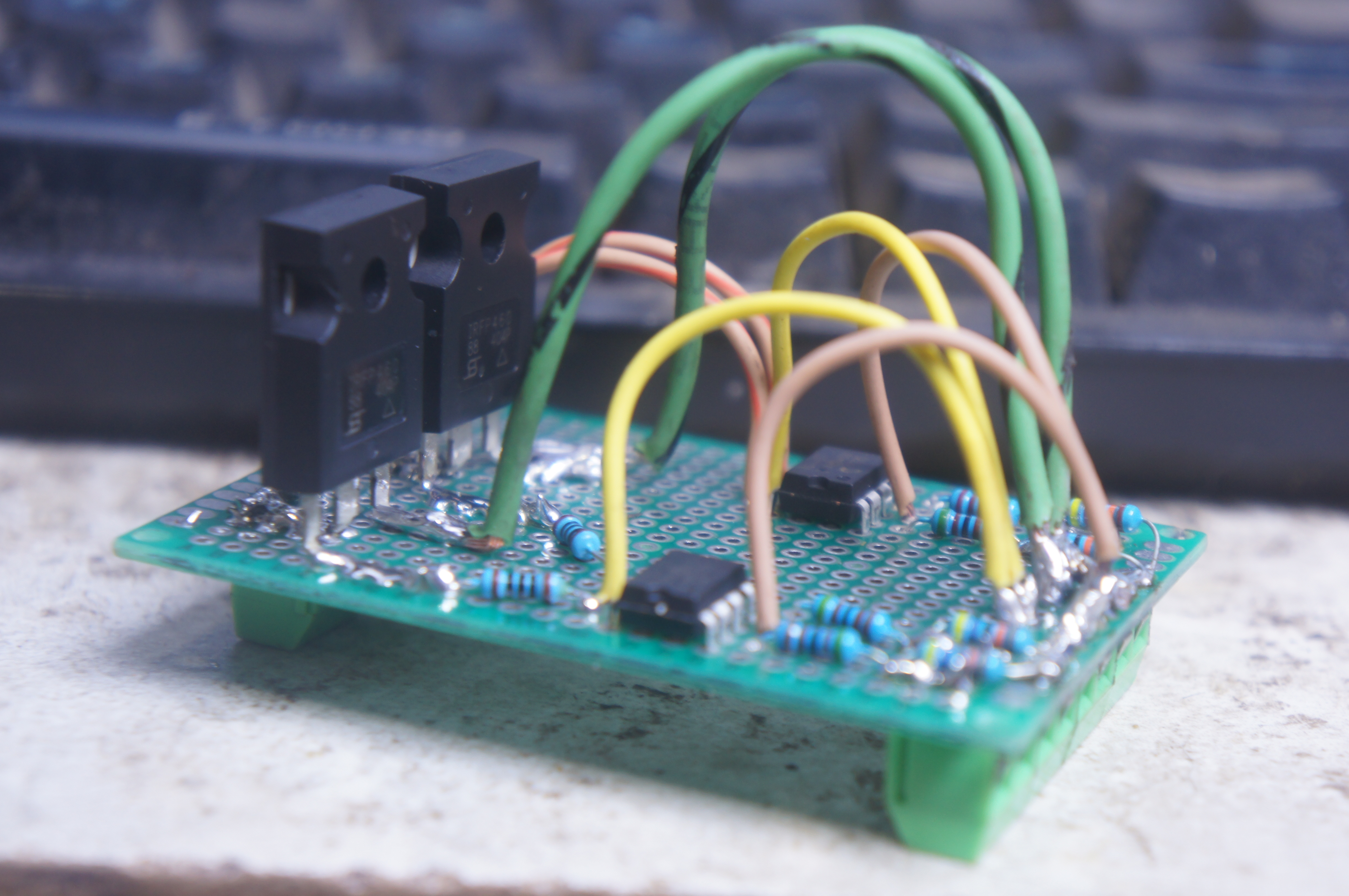

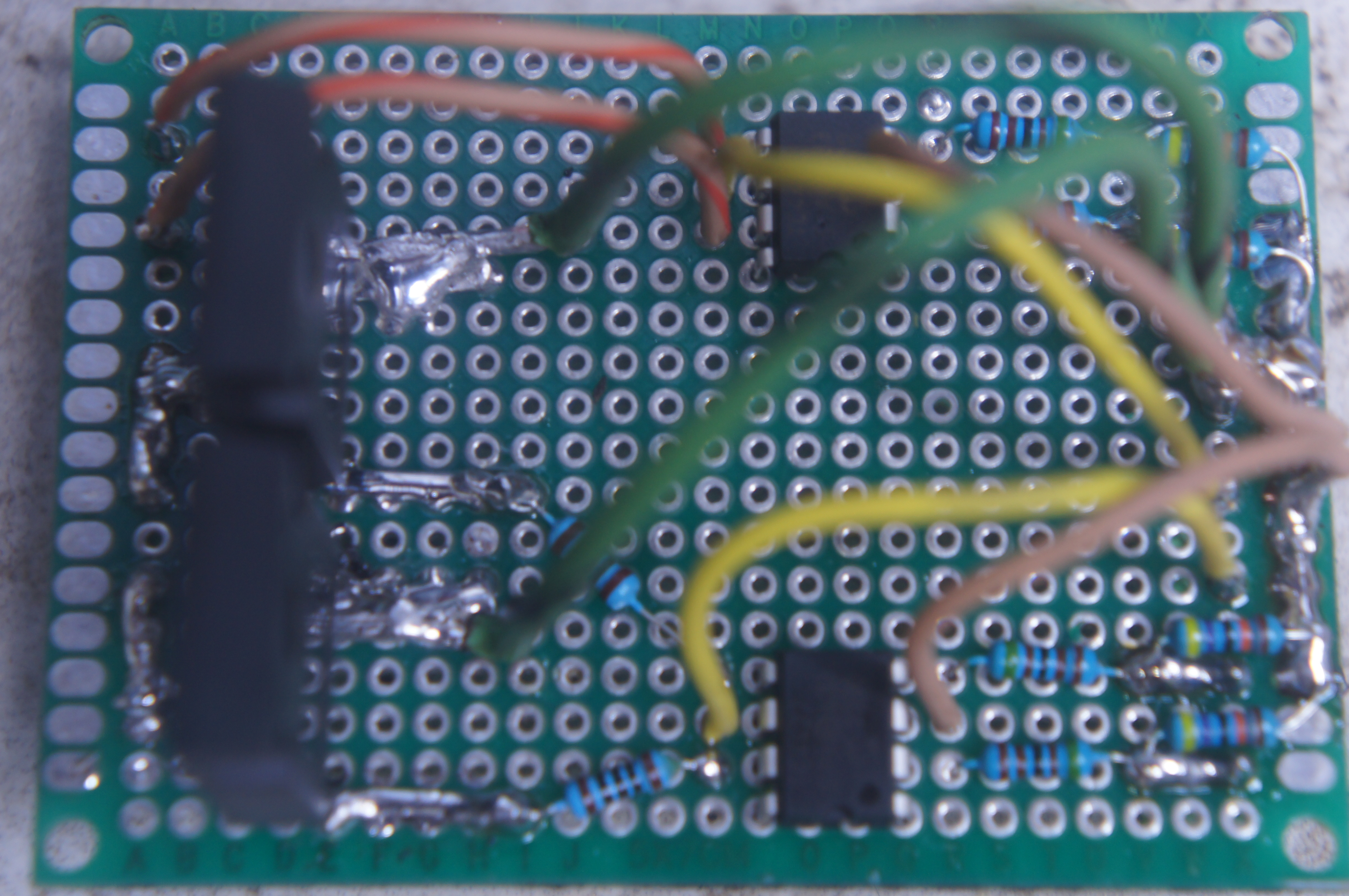

Should do for testing. 2 cylinder output board. Can test on a couple small engines I have. CB450 and 2 stroke snow blower.
Need to make the input board and add a cam sensor to the CB450 for a full sequential test.

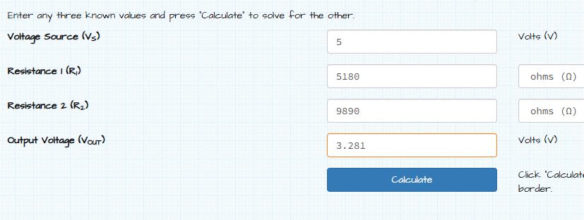

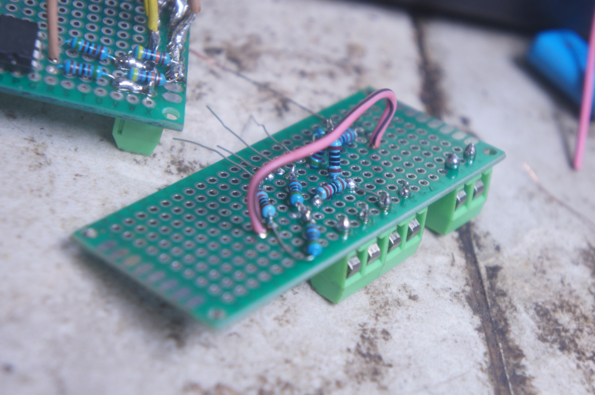

MAP sensor is 5 volt. Pi Pico will die from that... Um, good enough.
Turns out I'm out of female headers, but, voltage divider, pull up resistors, and bias resistor in this mess.

AngelMarc wrote: Mon Jun 23, 2025 9:42 am MAP sensor is 5 volt. Pi Pico will die from that... Um, good enough.
Thanks for reminder. I have been using a 5v map sensor supply into the pico. Must fix it before it kills the pin. :wtf: no smoke yet. Probably as it's mostly at 1-2v.

MPC001 wrote: Tue Jun 24, 2025 7:04 pm
Unclear on some details.
Just to be sure we're on the same page...
The power for the Pico is 5 volt, it has a regulator to drop that to 3.3. VBUS and VSYS if I remember right, are 5 volt input. You can remove a resistor or something to separate USB power I think.
Every other pin is not 5 volt capable.

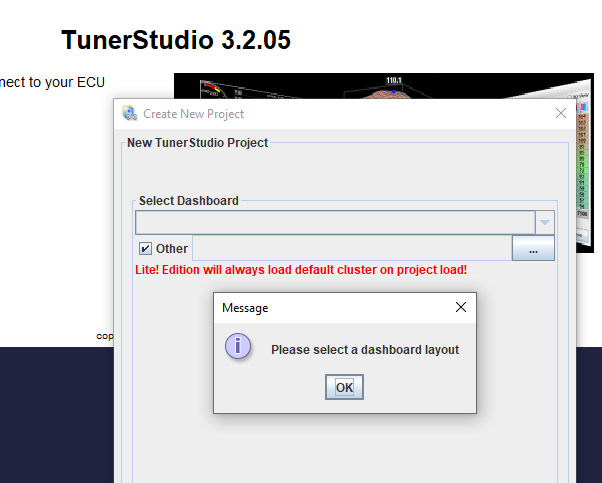

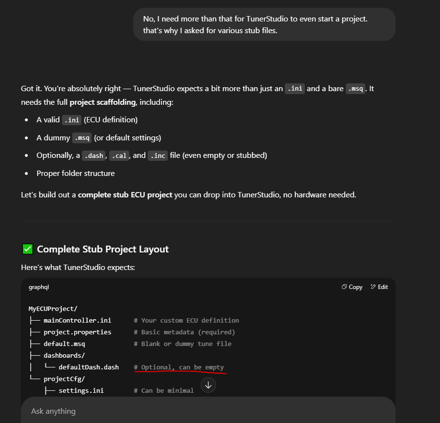

"Let's try using TunerStudio as the tuning UI. No live tuning, no flash/burn, just convert the saved file."
... or not
