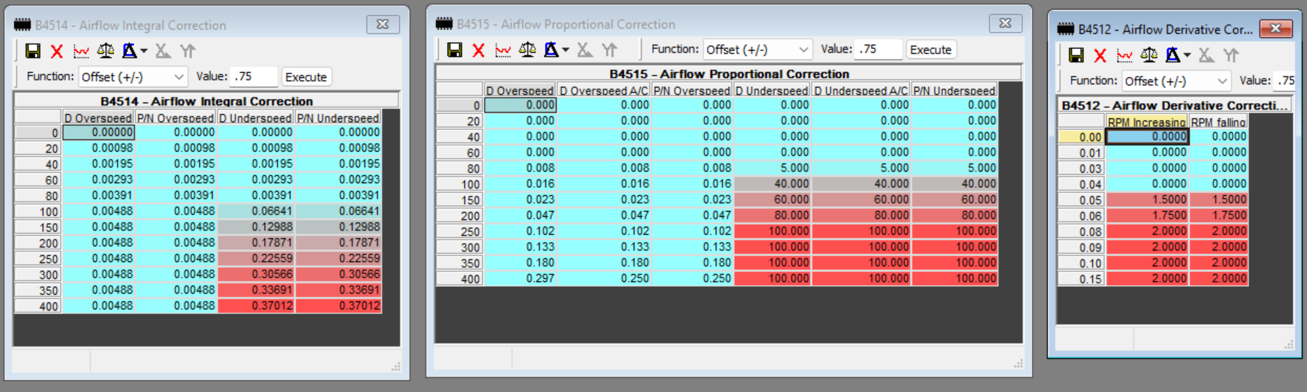

Got a new engine, and had to start over from scratch on idle tuning. I managed to get it driveable but still had some surging while coasting to a stop, or if I fixed that I ended up with some stalling instead. Went to a new tuner who made it surge less without stalling, but it was still annoying to have RPM bouncing around so much when coasting to a stop, and while stalling was very rare, it wasn't 100% gone.
Last weekend I got it good enough that I can finally give me wife the keys without feeling an urge to explain why it's always doing weird shit.
Some key things:
* Zero throttle cracker airflow, and/or set cracker to engage at 255mph / disengage at 253mph (so it never engages). As long as cracker is active, the adaptive idle stuff isn't, and that's what causes the surging and the stalling. It took me a while to realize that when the throttle blade is at a fixed angle (because adaptive idle is NOT happening), RPM bounces up and down, due to a combination of big cam and light flywheel. Disabling cracker enables adaptive idle to kick in at any vehicle speed. (For a looong time, I though that the surging meant that the values in my PID airflow tables were too high.)
* Increase the idle hysteresis to 1000 RPM. Apparently, (I'm not 100% sure...) this causes the adaptive idle to kick in as soon as I press the clutch pedal, at 1800 RPM or lower (800 RPM target, plus 1000 RPM hysteresis), rather than waiting until RPM falls down to the target RPM and then jumping into action (at which point it often keeps falling well past the target RPM).
* Lots of throttle follower - 2 g/s at 23% throttle and above. Zero decay when in gear, and pretty fast decay when the clutch pedal is pressed. The idea is to give it enough extra air to slow the return to idle when I press the clutch pedal. I was hoping that the hysteresis change alone would enable the adaptive idle to prevent stalling/stumbling on its own, but it does still need a little bit of help.
* Steep increases in the proportional and integral feedback tables when idle is more than 80-100 RPM below target. I'm still experimenting with this, but the screenshot below is not a bad place to start. The cells with the absurdly high values almost never come into play, but when adaptive idle doesn't kick in properly (which still happens every once in a while) they basically act like me stabbing the throttle to keep the engine from dying.
So anyway... now when I approach a stop light and push the clutch pedal, RPM drops to 800. Most times, it's perfectly stable. Occasionally, RPM drops below target and the feedback tables bump it back up once or twice before it settles down.
Getting cracker out of the way helped enormously.
The only drawback is that if I push the clutch pedal, put it in neutral and release the clutch before the throttle follower airflow has decayed to zero, it stops decaying, and nonzero follower airflow prevents adaptive idle from taking over, but and it get some mild surging, usually around 1000 or 1100 RPM +/- 100 RPM. But that's rare and it's pretty minor compared the surging that I used to have. And pressing the clutch for a second causes follower to decay to zero and then it idles like it should.
It's vastly better than anything I was able to achieve when I still had throttle cracker enabled, and it only took few iterations to get the follower dialed in. I wish I'd started with this approach.
Some key things:

Cool, thanks for shareing. Can you give some idea of what has changed that could have caused those problems to then need that approach? Larger TB? Different IAC?
Re: Return-to-idle tuning for a 2002 Corvette
Return-to-idle trouble issues are fairly common with...
* aftermarket throttle body (doesn't meet the PCM's assumption of blade-angle vs aperture-size)
* aftermarket cam (runs rougher)
* aftermarket clutch (weighs less, slows down faster)
I have all three, so it it was really bad at first.
I should have mentioned that I also adjusted the table that tells the PCM how far open the throttle body is for a given throttle blade position, to get it to open a little further. There's an "ETC scalar" that has a similar effect, and pretty much everyone adjusts that, but I have a hunch that more people should play with the area/angle table too. The scalar is used to convert from "square millimeters of opening area" to "percentage of opening area" and then the area/angle table is used to convert from "percentage of opening area" to "blade angle."
The "derivative" part of idle feedback is basically there to slow down the rate-of-change of RPM. If it's dropping fast, the derivative table will add airflow to slow the drop. If it's rising fast, the derivative table will remove airflow to slow the rise. (I'm pretty sure this is a slightly different from how derivate feedback usually works, but it's close enough and good enough. More about that later.)
The stall saver, if I understand correctly, and I'm not 100% sure I do, will disable the derivative feedback when RPM gets below the target RPM, so that engine speed can quickly rise to the target RPM. I haven't played with it for a long time, but when I did, I didn't notice any difference with or without it. But now that it's working better, maybe I should play with it again.
Also, I found another thing that helps a lot with the no-cracker approach, and added it to the list of changes above, plus a screenshot of the feedback tables that I have now.
