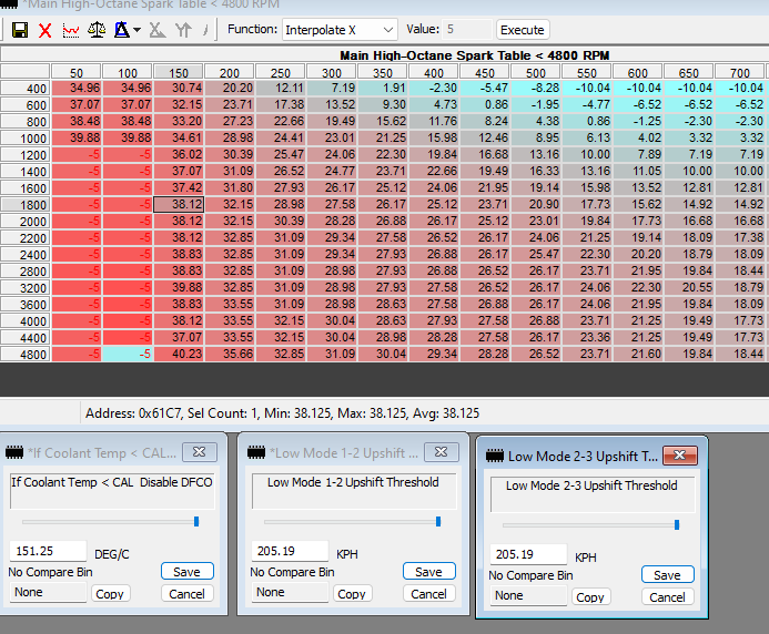

Blyco5 wrote: Wed Jul 02, 2025 1:37 am Hey just wondering if anyone has a tune for a vxcommodore v6 to manulise the auto to hold first and second and a crackle pop I’ve added the enhanced tune but hasn’t done much
set these tables like this
Screenshot 2025-07-02 055344.png (101.05 KiB) Viewed 82 times

Have you got a bin nd xdf file I don’t wanna stuff it up
Wade
Posts: 1122
Re: VS-VY Enhanced Factory Bins
Post by Wade »
Blyco5 wrote: Wed Jul 02, 2025 6:41 pm Have you got a bin nd xdf file I don’t wanna stuff it up
VX_V6_$BD_Enhanced_v0.9h.xdf
(423.7 KiB) Downloaded 5 times
VX_V6_$BD_Enhanced_v0.9.bin
(128 KiB) Downloaded 4 times
