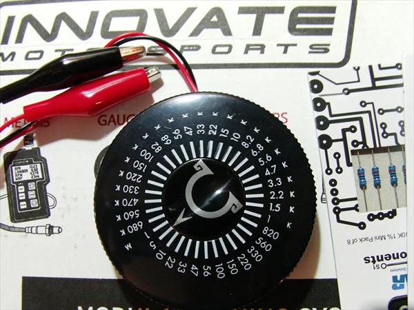

picked this up nifty little jigga from jaycar today. vl400 reckons try hooking up wideband with a resistor inline 100k then 10k.
its a stepped variable resistor, hopefully i can install it inline starting at a high value and dial it back until i get a reading in tp, all without blowing up my w/b preferably. and would be appreciated if someone can confirm this is the correct wire, b12 injector voltage monitor. thanks,

i finally have w/b logging working sweet as in tp. backed the resistor of to 1k ohm where there is no difference between the mtx display and the wide band in tp, seems very accurate. so now i have a 1k resistor inline. my theory is the 1k ohm is enough to stamp out the small voltage (0.050 ish)that was coming from the b12 wire which i suspect may have fied some thing, but not enough to make a noticeable error in tp display. unlikely, but thats the theory im sticking to.
