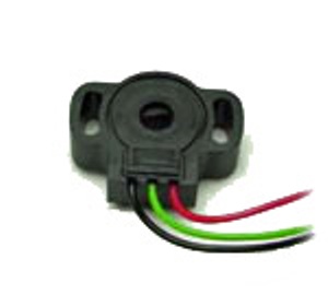

You can use a generic glorified potentiometer like in the attached image.
Used to be able to purchase them from RS components or Farnell(Element?)

that looks the same as the apparently falcon TPS i saw on a walkinshaw manifold i tuned.

I just had a look on ebay and you can get something very similar to what I posted above from the USA for about $20.00
