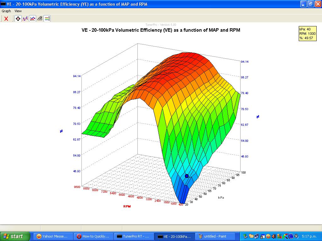

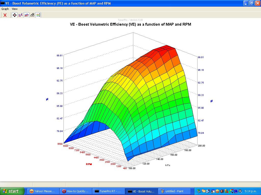

thought ide post up a couple of screenshots of what a tuned ve table should endup looking like if all your injector battery compensation, CATFAC etc settings are close to correct. saved making a seperate thread

WOW pretty impressive DW but Ive barely seen a VE table that smooth, has it auto updated at all?
- Posts: 5630
Re: The basics of tuning a delco ECM with $12P
i normally tune manually as im clicking through cells no logs just a wideband in front of me.those maps are pulled from my new 12p base tune and were created off my old tune done in kalmaker.i do smooth manually after tuning but generally your only talking 0.3% ve to get the map smooth enough.now that im all up and running on 12p im loving wideband logging allready

Thats a great idea & easy for people to work with nice work DW!
