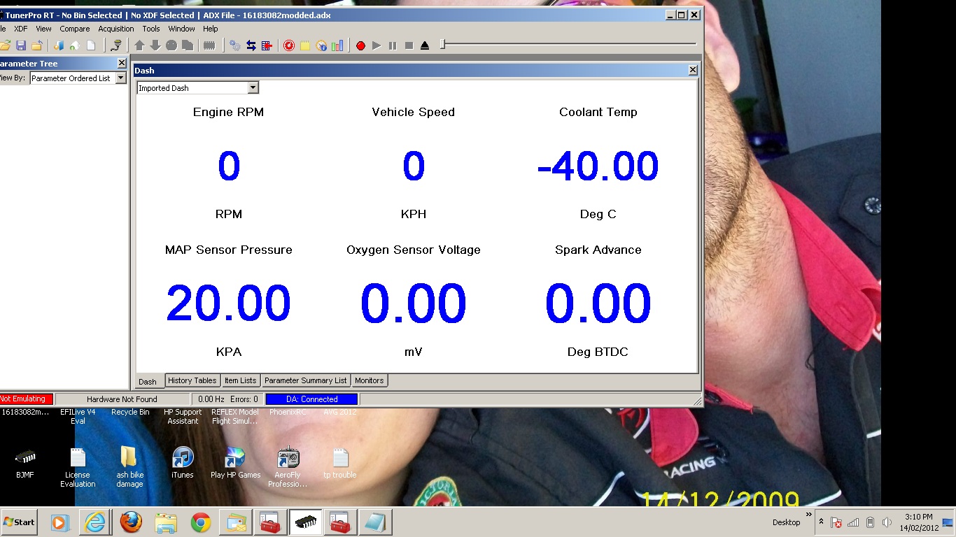

almost there. ive managed to be able to connect but it wont log any data or dashboard wont display. ive attatched a screen shot of what i have.

That file isnt set up for tunerpro 5 (tp5).. its quite an old one.. use the one inside this zip: VR_$11_v1.04-tp5.zip from https://pcmhacking.net/forums/view ... ?f=10&t=29

python wrote:almost there. ive managed to be able to connect but it wont log any data or dashboard wont display. ive attatched a screen shot of what i have.
I can see your problem. Its obvious to me. You have got your monitor screen facing the wrong direction. From what info I can tell you is that your engine has stopped and your road speed is zero. Be wise to wrap up real quick as your coolant temps are displaying -40 deg C.
Worst thing is you might be out of air soon as your Kpa is only 20. You really can't trust these imported Dashes. :thumbup:
