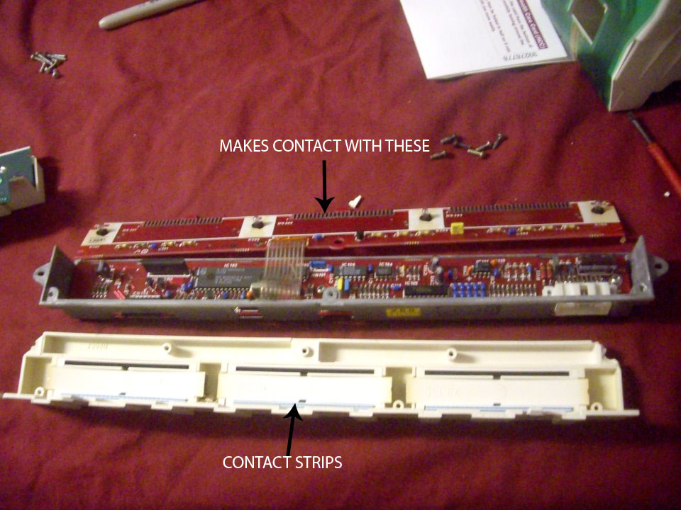

Well i got around to taking it apart and having a look, Everything appears to be ok, just 2 LCDs arnt playing the game. One particaly reads and the middle does not display anything. Here are the sad photos.
I guess its not a standard little LCD screen is it? I need to buy a whole new cluster?..

no there not standard lcd screens, if you pull that apart under the lcd's there is those contact pads i mentioned.

Which are you talking about?
Posts: 4810
Re: Level 3 LCD screens
the rubber strips connect the lcd's to the tags. Swap the contact pads from the left working screen to the middle and right and see if they come good, to test and see if it's the pads or the lcd's

Thanks for the reply. I think its the LCDs that have had it, same deal. Ill have to buy another one, testing before i pay for it.
