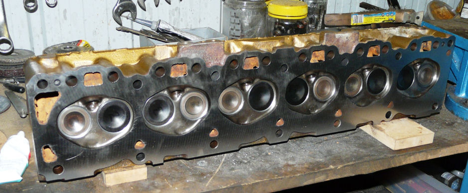

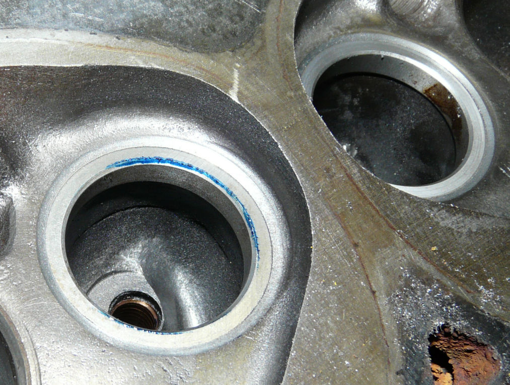

the other day went to my mates workshop, we worked out the smallest possible seat that would mean minimal head removal so as to avoid hitting water galleries, it seems that it worked :D
so this arvo picked up the head to blend the new seats into the ports then she'll be going back in tomorrow for final cutting of the seats and decking.
so this is how i got the head today as you can see nice new clean seats, but the underside of them was a bit square and stuck into the ports a bit.
don't ask me why the pictures have the brown tinge to them cause those bits are bright silver colour where i've blended the seats in ... anyways you get the idea

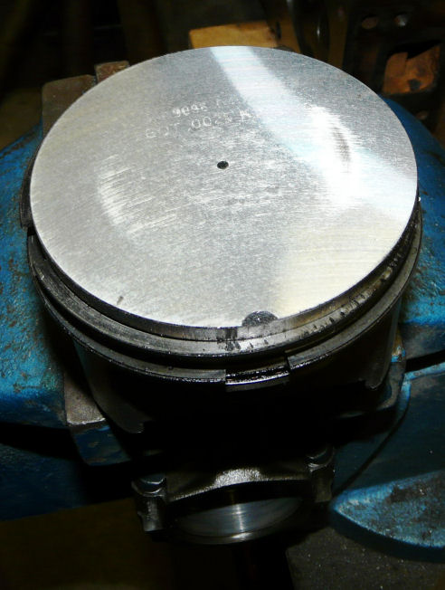

ok firstly the pistons, this is what i started with originally ... these are ACL Race Series rebuild pistons the same ones they use in the HQ Race Cars. As you can see there is a 2.2 cc bowl in the top of them.
and this is after they went through the milling machine.... bare minimum removed to get them flat.
hopefully tomorrow i can get some of the pistons in the motor and measure exactly how much has to come off the top of the block then thats pretty much the end of the machining and it will be assembly time!!

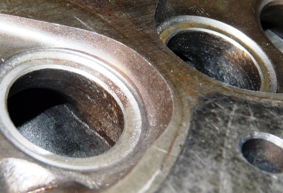

also today i got the head done .... i think they said they took about 20 thou off it to get it to the CC's i wanted not too bad really. nice 3 angle valve seat job too
good as new, bye bye valve seat recession :punk:

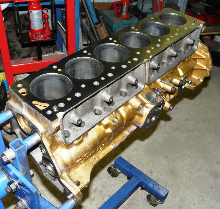

well not alot to look at thus far ... BUT ...
got the crank and cam in, aswell as some other little bits and pieces ... still waiting on my ARP rod bolts which is now being a bit of a pain and holding me up ....
in the mean time i have been removing carby fuel system bits and getting stuff ready for my new surge tank that will arrive shortly ... then i can start fitting that up if i'm still waiting for the bolts.
either way slow progress is still progress!

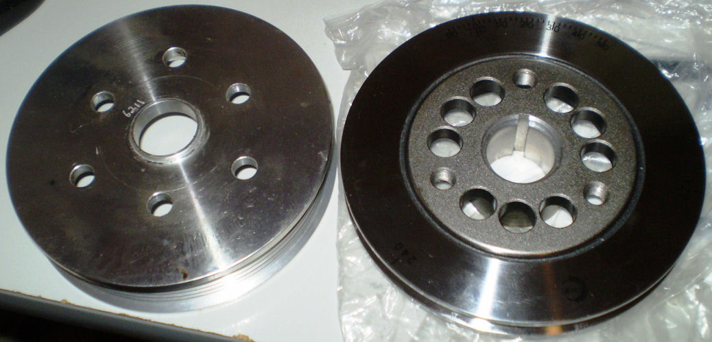

jumped on me mates lathe tonight and got the groove in the end of my balancer sorted so my serpentine pulley is a goer ... balancer can be installed now!!
