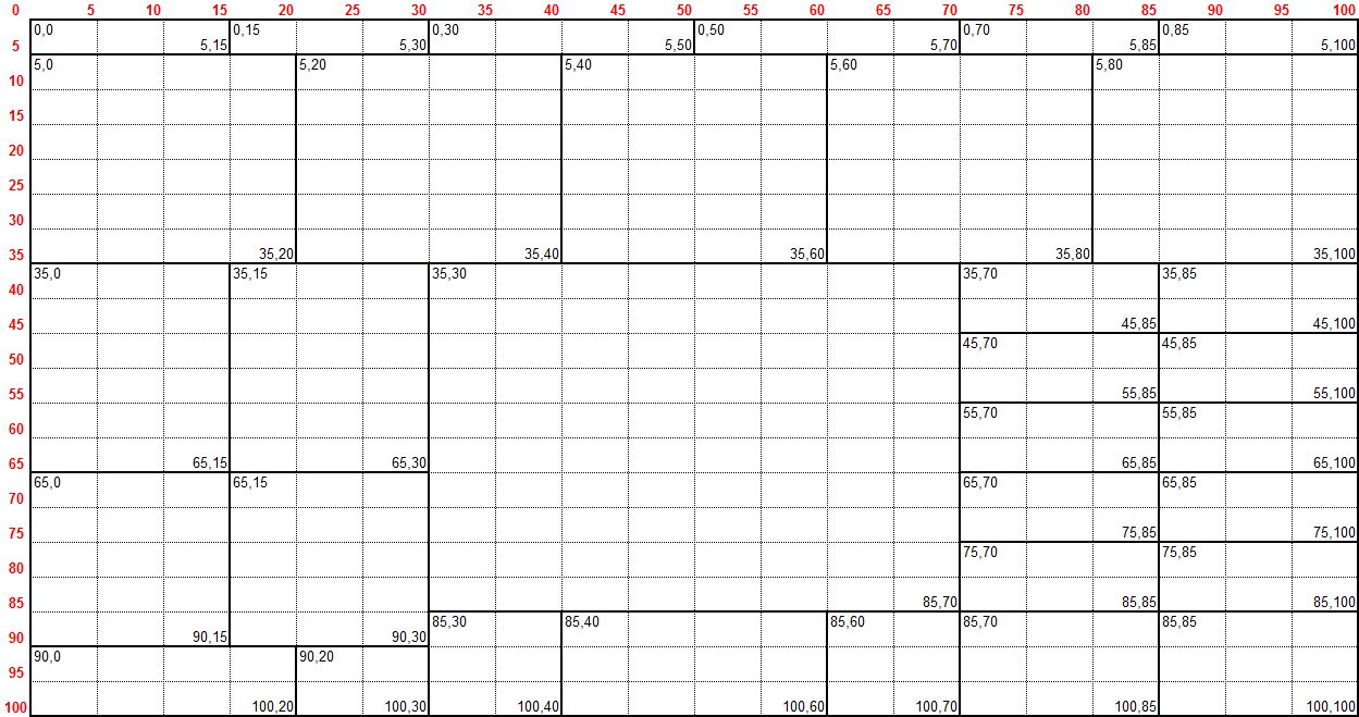

I'm sure a few people on here have had the same problem as myself trying to layout a TP5 Dashboard and keeping track of the Top Left and Bottom Right Coordinates.
Have created a fairly simple Excel Spreadsheet, to hopefully make this task a little easier.
It is not super robust, and can easily be fooled and not work at all, but if you follow the simple instructions it should be fairly Straightforward.
Below is a Screenshot of the Output.
Any questions or feedback let me know.

EDIT: Have Updated with ability to change Scaling from 5,10..., layout is basically for a widescreen.

Have updated in first post with the ability to change values in Red to alter scaling.
Note that for values less than 3-4 it can be hard to read, and all 20 Values need to be populated.
