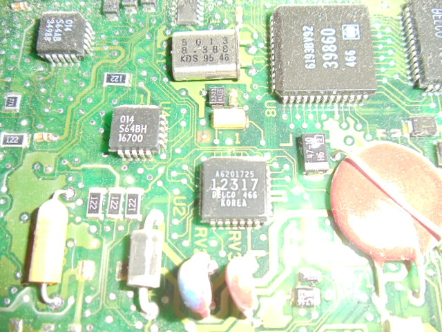

Hi Guys,
I am having trouble locating the ground to connect one of VL400's usb comm boards on my VS v8 manual board (16206305).
In the instructions provided the tracks are different to mine.
Pics attached.
Thanks, Adam.
16206305 locate ground for usb comms board..

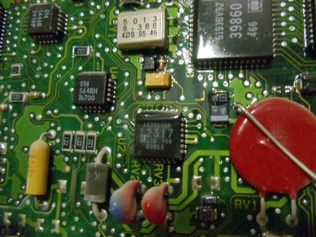

Re: 16206305 locate ground for usb comms board..
more pics attached - thanks.
But the '305 already has high speed comms...? Just need a different plug at the diagnostic connector
admj1 wanted to install a USB comms board internal to the '305, which is possible but also not the most common install.
just an update - wanted to install usb comms as the ecm was to be installed in a vn which didnt already have the newer aldl connector..
advice to others would be to download the latest version of the install instructions - i had an older version!
good luck everyone!
