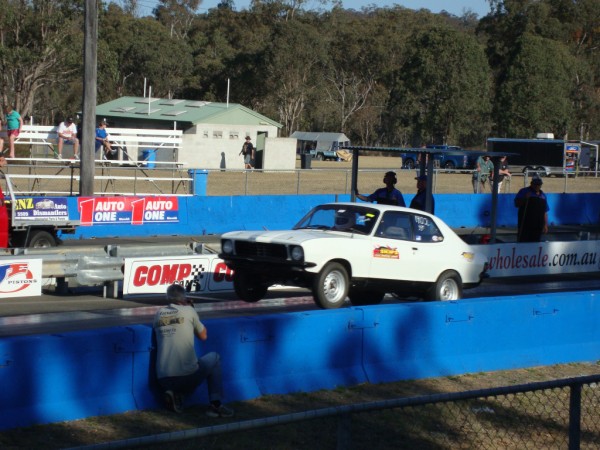

heres a vid of my brothers car, as you can see he struggled a bit but it was hit first ever run, and the car sure did work once he got on it

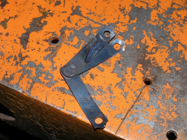

Yes I did break the clutch slave cylinder bracket. On closer inspection I found the real reason why the bracket was in 4 pieces. These pressure plate drive straps belong here. Also bent another set. The rivet that attaches the straps to the plate has sheared when I let the clutch out at 6000rpm. Now to find the $1000 for a different type clutch & a steel flywheel. On the positive side the blue Smurf went well, but I'll discuss that elsewhere.

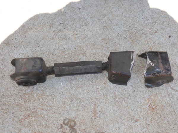

I went to the 2012 6 Bangers at Warwick last month. The ran consistent 8.0s all weekend with a 7.994@85 mph.
I had some traction problems, here's a couple of pics This happened on the last pass. I couldn't work out why I lost 2/10s & was a bit loose in the top end.
Rear upper trailing arm.

i'm seeing a common theme with your car, i think you have too much HP or too hard of a launch for your parts

Upon inspection the arm had been cracked for some time, I suppose it wasn't really designed by Holden be "abused" like it has been for the last 11 years.

i never said you had too much HP, just too much for your parts
