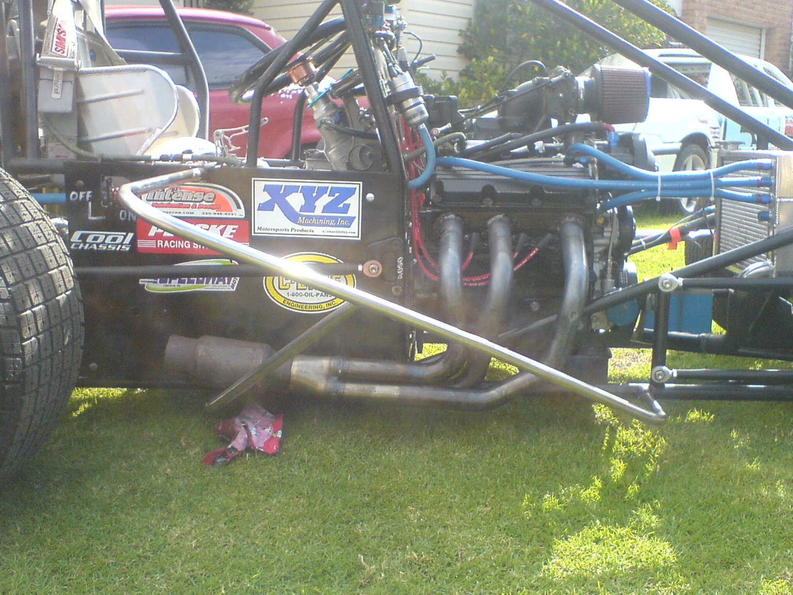

very suprised that the standard tune works with methanol .... be interested to see a dyno graph of it i just don't see how that much change in fuel can work
i guess the exhausts would be about as free flowing as you could get .... do they sound different to your average v6 with exhaust ?
the engine looks nice, i like the inlet hahaha and thats a tidy looking sump, makes my ecotec sump look downright dodgy lol...
nice work getting the pics man you've done well!

ive got a mate with a vr sprint car running a ecotec v6 and as far as i know the computers are sealed by cams here in sa but from what a friend told me they run a 808 with a modified apnx tune for e85
- P2280001.JPG (1.7 MiB) Viewed 4344 times
- Posts: 5493
Re: Commodore V6's in Sprint Cars
there you go holden202 closest i have to a full image of one LOL ill ask the guy for more pictures or tell him too join .hes having a few issues so he should join anyway
