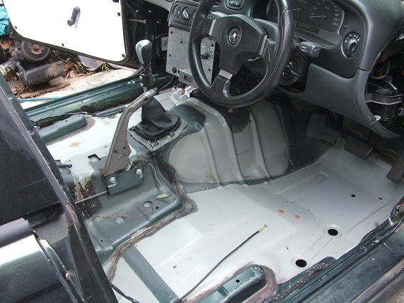

I took festys advice and my own peace of mind in replacing the door covers with some board from a my mates cabinet making shop.
Much easier to work with too. Next up was cleaning the interior ready for painting. I decided on using charcoal/silver hammertone paint which applies easy and dries quickly as well.

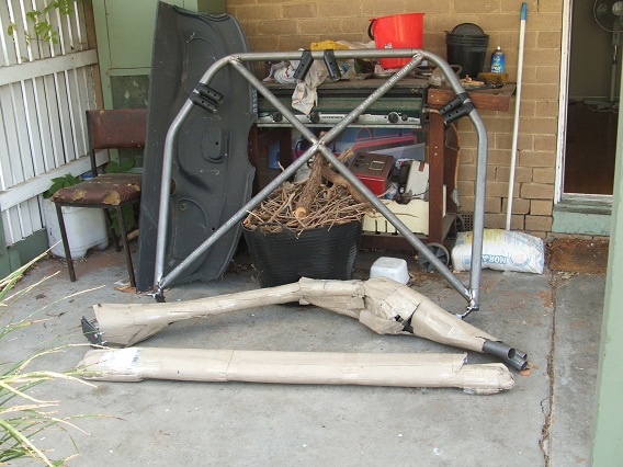

I finally got around to ordering the cage.
Bond rollcages came to the party (4 days from phone call to delivery from sydney to melb)and
looked after me with a 6 point cage with side intrusion on both sides and i also ordered the cage

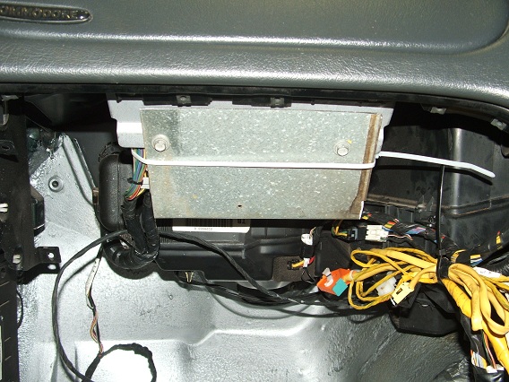

with the extra diagonal in the main hoop to carry a passenger if i want/can. Another bonus with with a pov pak c/dore is that i found a neat spot for the PCM.
The passenger side non-air bag shute

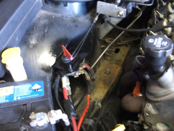

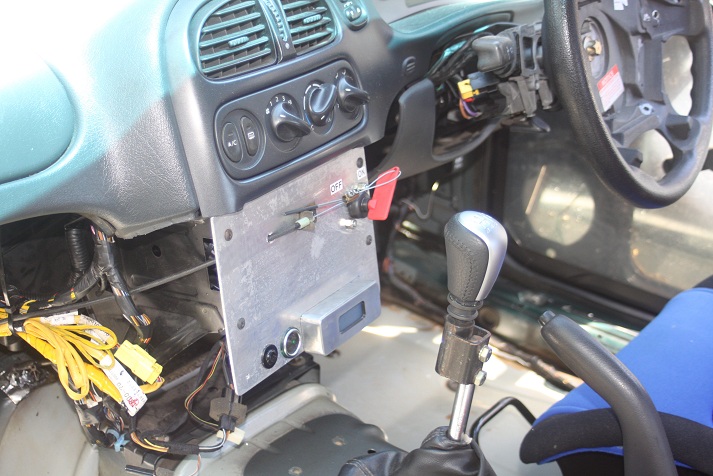

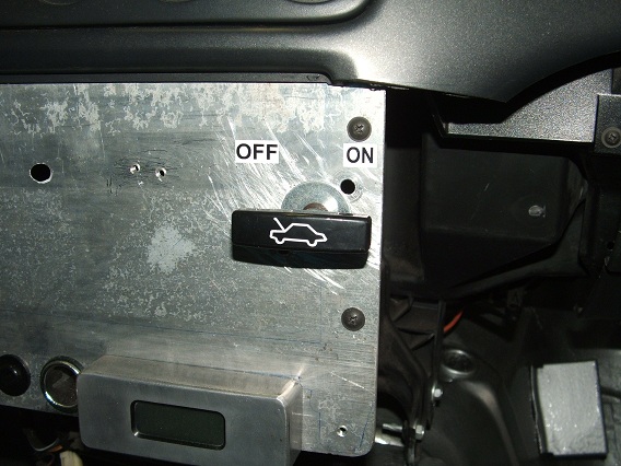

The other pain in the arse was the isolator switch to cut all power off.
I originally had it half setup to operate in the vehicle from my seat but with the headache of buying extra cable and holes in the firewall
i decided it was easier to mount the switch next to the battery and add an extra pull cable for me on the dash. So that crap is out of the way

thats a great idea, the closer to the battery you can isolate the better the safety .
Although I would of mounted the pull cable bracket on the isolator so the cable can still pull correctly even if that area get crushed in.
atm your setup would mean the cable would be too slack if the isolator and cable bracket got pushed closer together and thus might not be able to pull it tight enough to open the switch.
just an idea to play with.

You are right there.
Thats how i wanted to mount it but didnt have any metal long enough to mount the cables to the same bracket.
It will get done once i get more steel/metal.

If you're planning anything more that supersprints, you'll need the battery isolator to be accessable from outside the car near base of the driver's A pillar. The usual method is to mount the isolator switch near the driver, and run a pull cable to the scuttle panel.
I suppose you can always run a second short pull cable - or even a second isolator switch in series with the first, mounted below the windscreen...
Or if you re-locate the battery inside, it becomes really easy to fit an isolator at the dash because the battery lead runs right past.

I was quoted anywhere from $2500 -$4000.00 for a basic weld in cage.
A couple of mates run the bolt in Bond cages in their race XY falcons so i went with the bolt in as well.
$1600.00 inc delivery to melb with the extra diagonal in the hoop and intrusion bar for passenger.
The plus side is that its sellable again if i want to.
I do have a cable at the A pillar festy And here I did have it here but the lack of battery cable from the alternator to inside the cabin switch and cable from the battery to the switch
put me off for now.
I'm not even sure what they charge for battery cable per metre these days,but id like to mount the battery in the boot
oneday and have the switch back in the dash.
CAMS reg:
Each automobile of the 2nd and 3rd Category shall be equipped with a battery isolation (master) switch which
isolates the battery and stops the engine. It shall be capable of being operated by the driver in his normal
seated position. There must be a second switch, or a remote means of operating the main switch, from the
vicinity of the base of the A pillar on the driver’s side or, for an automobile with no A pillar, in a comparable
position. This external device shall be clearly marked by a symbol showing a red spark in a white-edged blue
triangle of minimum edge length 150mm.
