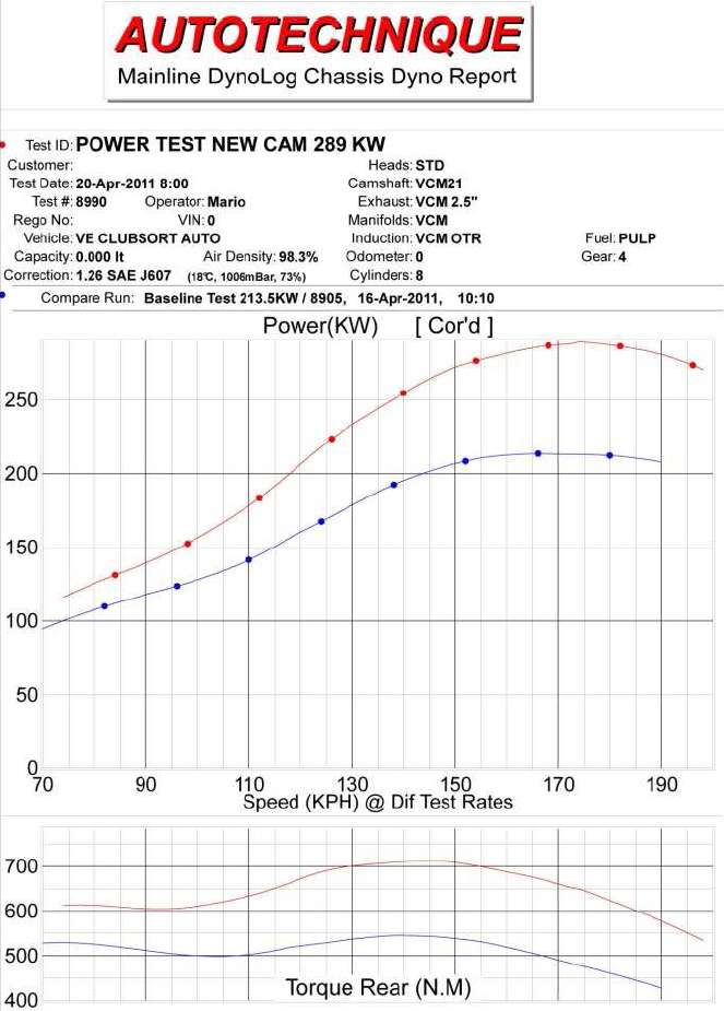

VE Clubsport Auto 6.2 - stock
Initial runs resulted in a lowish 213.5 rwkW (remembering that it doesn't matter what the figure kicks off at, more to the point is the gain and the driveability that matters) Fitting a full VCM exhaust of 1 3/4" tri-y headers/cats and twin 2.5" cat-back, VCM OTR and VCM-21 camshaft liberated a not insignificant 76 rear wheel kilowatt, and 170 Nm gain. Add to this how the torque increase remains flat across the board with the worst case increase of 100Nm but with more than 150Nm almost everywhere else.

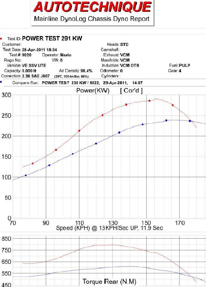

Sample 2
VE SS-V Ute 6.0 - Tune, VCM OTR, headers/cats and twin 3" system. We had previously fitted our OTR etc (as shown above) and most recently a 3.7 diff ratio (you see this in the dyno graph with the latter run falling off earlier). The 'First Round' Figure came in at 238 rwkW, then with the VCM-21 in place the 6.0-litre jumped up to an impressive 291rwkW for a 53 rwkW along with a massive 195 Nm gain. Bottom line: A 50 or so rwkW gain is not to be sneezed at. However what is even more significant is that both samples 'leave the hole' like scalded cats. It's no wonder the owners are rapt in the result.
Sample 2
