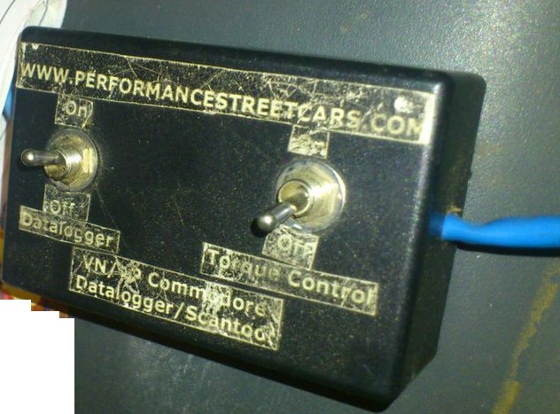

hi guys,
im trying to get logging working on my 808 ecu with tuner pro rt v5.
so ive got a kalmaker tune, N05 (i assume as im running a 2bar map sensor).
i have an aldl cable that came with the car (see pic).
i can log with that cable using winaldl at 160 baud using the 808 as the ECM type.
i am using a serial to usb converter, with FTDI chipset.
i have tried to get tuner pro rt to datalog but i cant get it to connect...
i grabbed the 1227808 ads file from the sticky in this section.
i have converted the 1227808.ads to .adx file using tunerpro rt.
i have selected the correct com port for my converter. the interface test cant find my cable, but i assumed that was bcos it was trying to do it at 8192 baud.
when i click the acquire data button it says "connecting" but never connects.
Does anyone know what the problem could be?
Has anyone used that 1227808 ads file to successfully log in tunerpro?
i noticed that the ads file definition has the baud rate set to 8192..... shouldnt this be 160?
Thanks
Rob

I would try the kalmaker SP3 ADX with TP5 in the filename for an N05. You might need to change the equasion for the MAP to get it to read correctly as I assume the scale is wrong. This assumes you have an 8192 baud interface. I cant confirm that data will line up though, and cant really troubleshoot further if it doesnt just work as I have 12P on my car. Other than keeping an eye on data such as engine temp which moves slowly, 160 baud is pretty much useless for tuning. TP5 requires different connection setup stuff that is not present in TP4, so importing an ADS will give you a base but requires the connection macros to be set up to get a link. This is why its better to start with a TP5 ADX. I cant comment on that interface, ive never seen one of those before, either. Perhaps it is 160 baud only?
- VL400
Re: ALDL Logging on 808
With a datalogging on/off switch I will bet its a 160baud interface only. The early ECUs required a resistor to get data flowing on the CEL wire. Try winaldl, that works with the '808, not sure about Kalmake though. http://winaldl.joby.se/

yeh the interface is only 160 baud at the moment, i dont have the 8192 going yet on my ecu. yep winaldl connects ok but its a bit basic.
