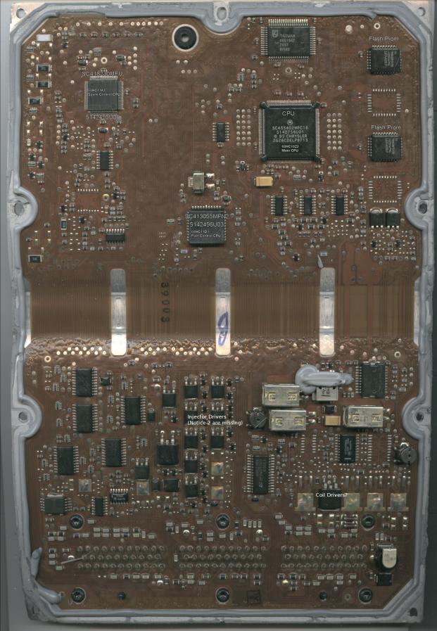

- VL400
Re: New member with non GM PCM help wanted
Thats some interesting construction using the flex board.
Once you get to these more complex ECUs disassembling them becomes exponentially more difficult. Sometimes its good to have disassembled simpler (read older) PCMs first to get an idea of what goes on in there.
