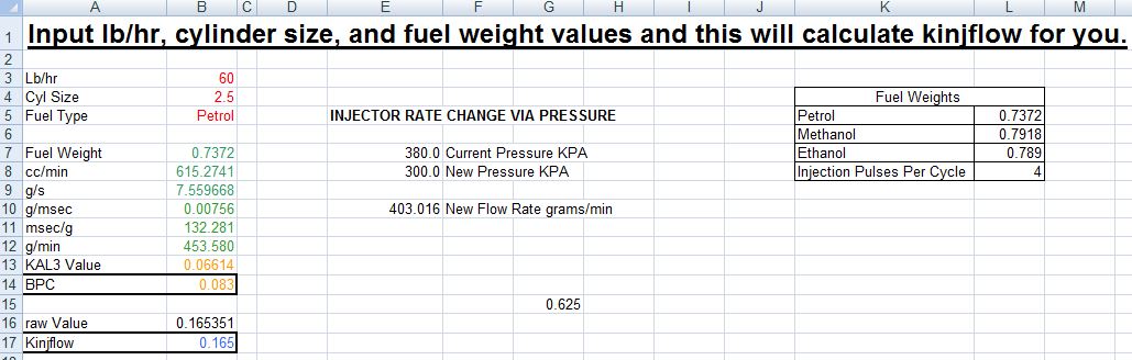

Before I take it for a ride, I had a couple of questions.
Should I change the bin to 2 Cylinder (TBI) mode? What is the difference between the memcal netres setting and the setting in the bin?
When I set the flow rate, I scaled it based on the value in the Isuzu bin (Isuzu flow rate * fiero displacement / isuzu displacement * fiero injector size / (isuzu injector size * 4)) rather than using the kinjiflow spreadsheet because I wasn't sure of some of the settings in the spreadsheet when doing a TBI setup. Is my flow rate in the right range for my setup?
In the log file, it looks like knock sense is on. What setting do I change to disable that?

cerulean wrote:Should I change the bin to 2 Cylinder (TBI) mode? What is the difference between the memcal netres setting and the setting in the bin?
The memcal netres controls how often the injectors are fired, while the bin setting changes the RPM calculation. Being a TBI setup your memcal will be fine and fuel will be injected on every reference pulse to the ECU. The cylinder number in the bin should be set to 4.
cerulean wrote:When I set the flow rate, I scaled it based on the value in the Isuzu bin (Isuzu flow rate * fiero displacement / isuzu displacement * fiero injector size / (isuzu injector size * 4)) rather than using the kinjiflow spreadsheet because I wasn't sure of some of the settings in the spreadsheet when doing a TBI setup. Is my flow rate in the right range for my setup?
You can use the kinjflow calc and change the injection pulses per cycle to 4. Is the fiero injector size around 22lbs/hr?
cerulean wrote:In the log file, it looks like knock sense is on. What setting do I change to disable that?
There is some info in the FAQ, see "How do I enable or disable the knock filter?" https://pcmhacking.net/forums/viewtopic.php?f=7&t=1396
The Bin your using has it disabled, you will still see knock counts but the knock retard will always be 0deg.
The Fiero has a single 60lb/hr injector.
I changed the pulses value to 4, but am not sure about the injector size (lb/hr) and cylinder size for a tbi setup. Do I enter the injector size for the single injector (60 lb/hr)? Do I enter 2.5/4 in the cylinder size for a tbi setup?

Re: 12P Pontiac Fiero 2.5 4 cylinder, manual tranny
TBI is not something I have much experience with, but it looks like the kinjflow calc has not taken in to account the inj pulse per cycle value. The calc in cell B10 needs to reference L8. Try with 0.083 as a start, but at the end of the day so long as the VE table gives the tuning range you need (ie does not need to go above 100%) then your ok.

VL400 wrote:Try with 0.083 as a start, but at the end of the day so long as the VE table gives the tuning range you need (ie does not need to go above 100%) then your ok.
I'll change it to 0.083 and take it for a ride.
