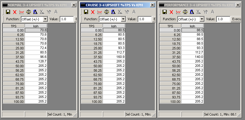

Without looking at the log 70km/h is about normal for a VY.
Have a look at a standard bin and matching xdf and look at the trams shift tables to understand how the transmission is programmed to shift. The strategies between VR and VY are very different.
VY also has 3 different strategies (shift maps) for when using power, normal and cruise control.
Yoda69

yoda is exactly correct, have a look at the 3-4 shift points for a VY V6:

So in saying that, my car is shifting as it should be? Only reason i ask is because as soon as i noticed the shifting wasnt what it had been, my fuel consumption went thru the roof and hasnt settled down yet. just under half a tang from 140 kms. but not throwing a code when i did the diag. the only thing i noticed was the quad driver fault 1 & 2 and the low spped fan code 92 but have been told that is normal

Yeah it seems like it is operating correctly.
