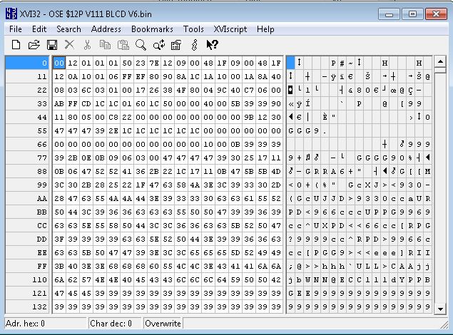

annnnd for lack of a better hex editor:
good old flashtool link

same as jayme, but 010 editor for hex!

I use HxD as my hex editor reconfigured to double the width to make better use of 1920 wide screen.

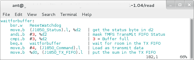

When writing pcm code I tend to use the GNU assembler, but I guess most people would never need to go there.

And good old vim on linux for hacking away at assembly code.
